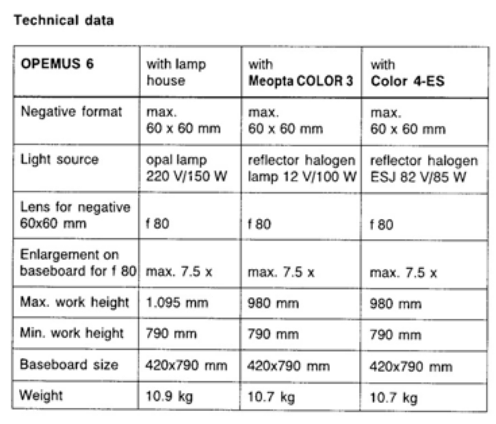

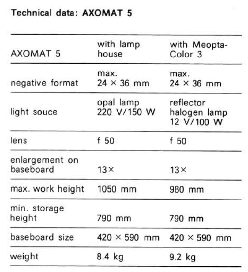

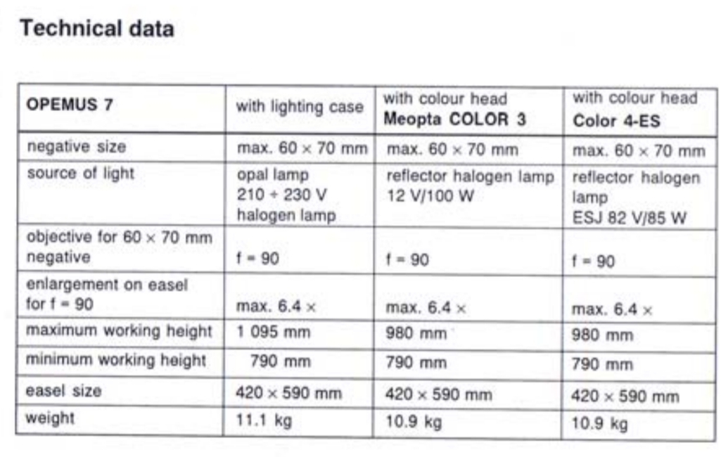

some specs...

Thank you for the information. I was wrong: The max. work height is nearly the same, but the base plate of the Opemus is quite larger.
