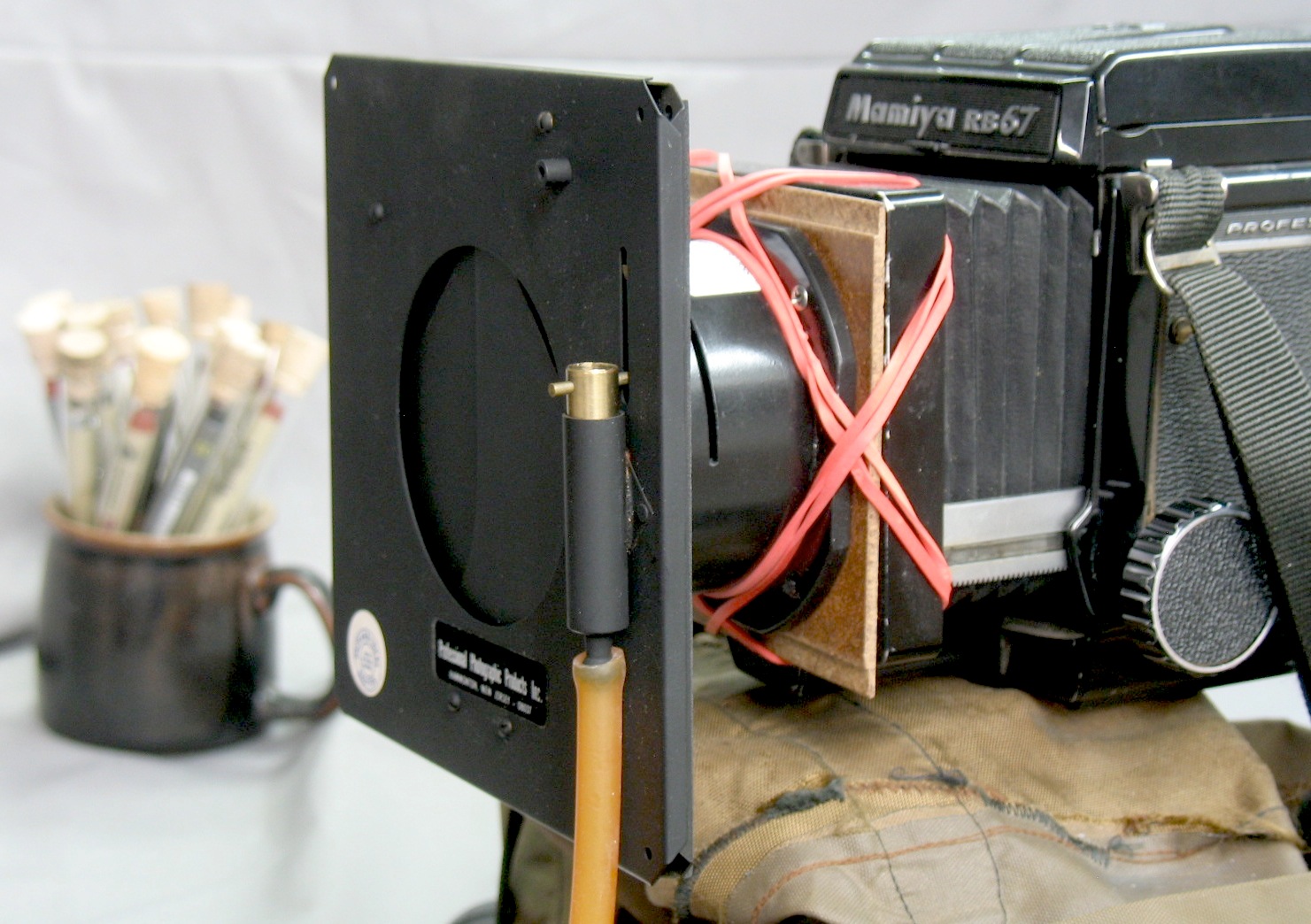

I just finished a 120mm f:2.1 Wollaston meniscus lens for a customer's 4x5 camera.
Someone asked about one for an RB67, but the RB mount is complex.
To show how the lens renders an image on 120 film, I lashed the lens onto my RB…
Here are three images taken at various apertures (and the rubber band lash-up).
The lens board is a hardboard clone of the common Linhof Technika board.
So the customer can use the lens on his RB, as well as his 4x5 camera.
A Packard shutter makes controlling exposure times simple.
The results were so pleasing that I'm starting to design an RB adapter for all of my LF lenses...

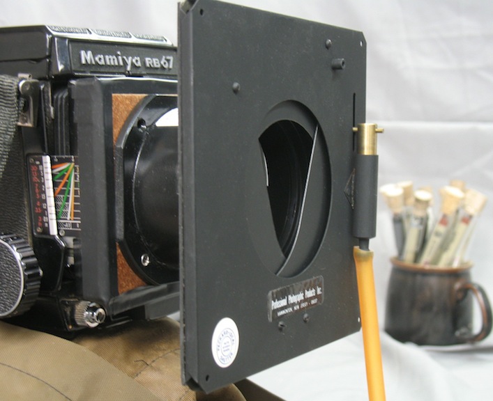

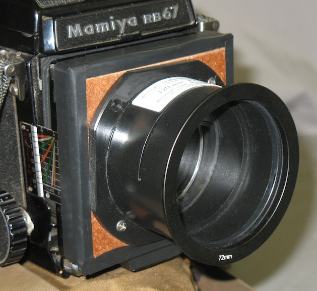

Designing an RB adapter is not simple, I'm still working on it…
In the meantime, here's an easy way to mount a lens to your RB with black vinyl electrical tape
In this example, the lens is on a hardboard clone of the common 96x99mm Technika board.
Thus it'll work on lots of 4x5's as well as any RB67.
