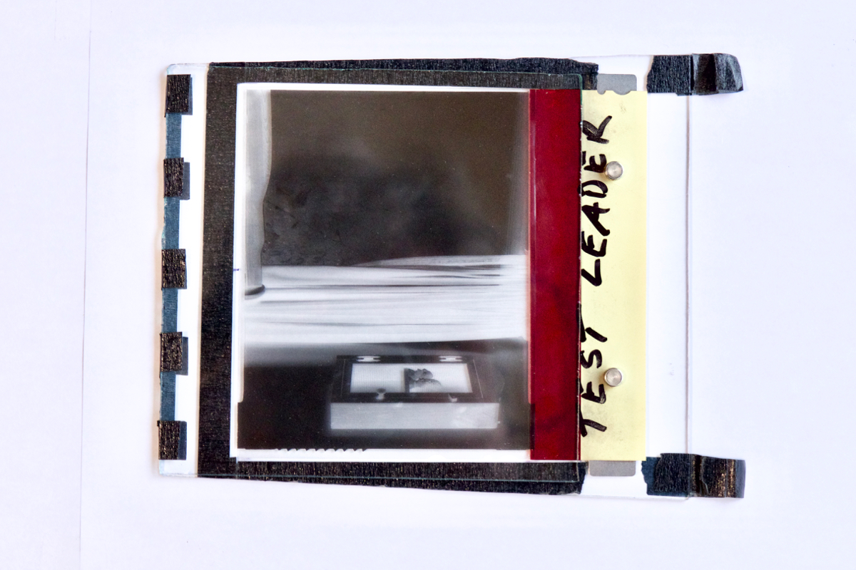

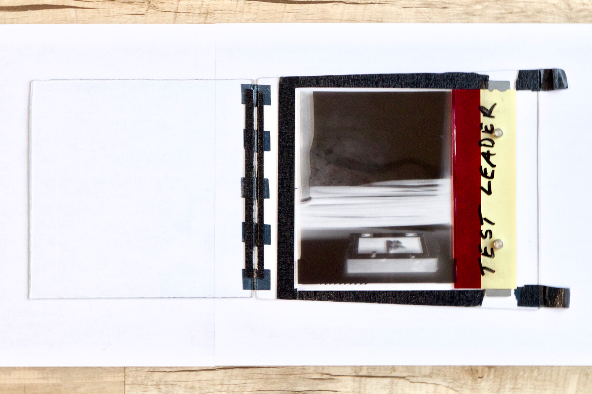

I've been tinkering with making precision masks on lith film for sandwich masking/printing of medium format negatives. I kinda made a makeshift registration system, etc.
I've experimented a lot and I think I'm coming to the "it's not worth the frustration" point in the proceedings. I've also noticed that most of the documentation/vendors in this area of darkroom stuff focus on large format negatives. I've read everything I can get my hands on (the usual suspects: Ctein, way beyond monochrome, the registration-sellers stuff, etc)
So, 2 questions:
-is medium format just too small to expect a repeatable masking workflow?
-semi-related: why are diffusion enlargers preferred to condenser enlargers for this type of tinkering?

Here's the photos of the pin registration negative carrier:
Thanks for the replies, Murray. Ive found the problem (for me, anyway) wasn't about registration as much as it was about creating usable masks on the lith film. Despite my best efforts, it often feels like luck if I get something usable, which is a lot of work when it feels the like the process is difficult to repeat with precision.
