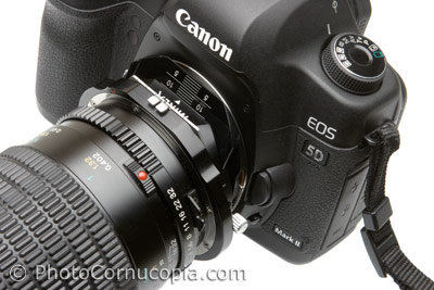

I used to use my Hasselblad lenses on my Canon DSLRs using a Mirex tilt/shift adapter. The results were fantastic even when just used without the tilt or shift.
When you mount the 500mm Mamiya lens on the Nikon it is still a 500mm lens and the items in the image will be exactly the same size as when the lens is mounted on the Mamiya but when mounted on your Nikon you will only be seeing the central portion of the full image so will give the apparent effect of changing the AOV and as you will have to enlarge the 35mm image more than the Mamiya image from the same lens to fit the same size bit of paper it will seem different.
The Mamiya lens will likely be bigger, have a smaller maximum aperture and you will be confined to stop down metering, if you can live with that for your Nikons then it might well be a good decision.
