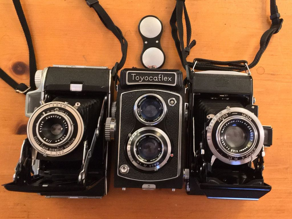

Courtesy of my Zeiss Ikon 521-2:
Scale focusing is good mental exercise :smile:
And that particular camera is in wonderfully good shape!
It is the camera on the right. the Kodak Tourist on the left is also good, but re-spooling on to 620 spools isn't my favorite activity, so I no longer have the Tourist.
