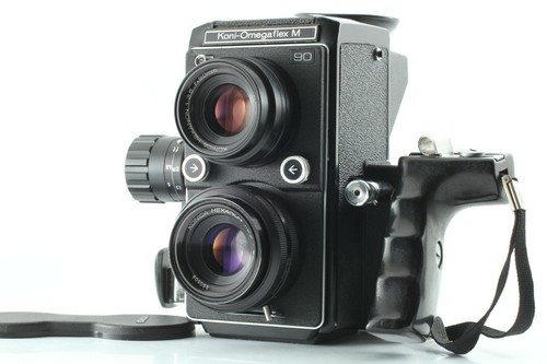

Non rangefinder? Not that many MF SLR that meet your need, compact for travel, a mirror adds weight and complexity. Other option is Konica Omega Flex, 6X7, not a true TLR, twin lens with direct view, there was a 45 degree attachment that sort of mimics a TRL. My parents bought me one when I graduated from college in 1970, great for portraits, not so good for landscapes, without a rotating back need to turn 90s degrees. I got my parents blessing and got a Mamiya C33 which I later sold and got a Yashicha 124G.
This is a fascinating camera. I have never seen this before; somehow I missed it over the years. But doesn't the film holder fit sideways so that it would be suitable for landscapes but tricky for portraits? Oh oh, now I have GAS.
Your right, 40 years does things to one's memories, got the back confused, don't know why, no way it could fit as in vertical orientation. The back is interchange and works with Konica Rapid.
What's this? I've had Koni Omegas but I've never seen one of these. I need more info.:smile:

I had the 90mm normal lens, lens ranged from a 55 or was it a 58 wide to a 180 long. The lens could be changed midroll as the back has a dark slide. It was not really a TLR, not waist level, direct view. The image was upside down and backwards, there is a 45 degree angle attachment, never seen one. At the time I was shooting a Konica T3, my parents knew I really like Konica lens so they figured the Omega Flex would be a good match. While in the Air Force I shot with a Konica Omega Rapid, lens are very good, but the ratchet mechanism takes a lot of wear and tear.
