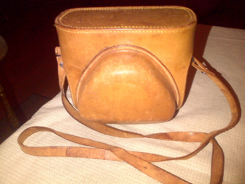

I bought a Medalist I from a reliable dealer for $175. Very clean and all parts working except for a frozen filter retaining ring. A late 1944 version with coated lens. Obviously never serviced since 1944. Sent to my repairman who serviced shutter to like new, adjusted focus and cleaned viewfinder rangefinder. Total cost, including cla:$250. A great camera. Through practice I discovered that camera is easier to hold steady with no camera shake when camera is in case. The case is also built to outlast the pyramids.

Allen from Cameraworks offers the same service clean and adjust rangefinder and focus scale and camera lens. plus cla for 125.00. I agree the camera case is built like a tank just like the camera
