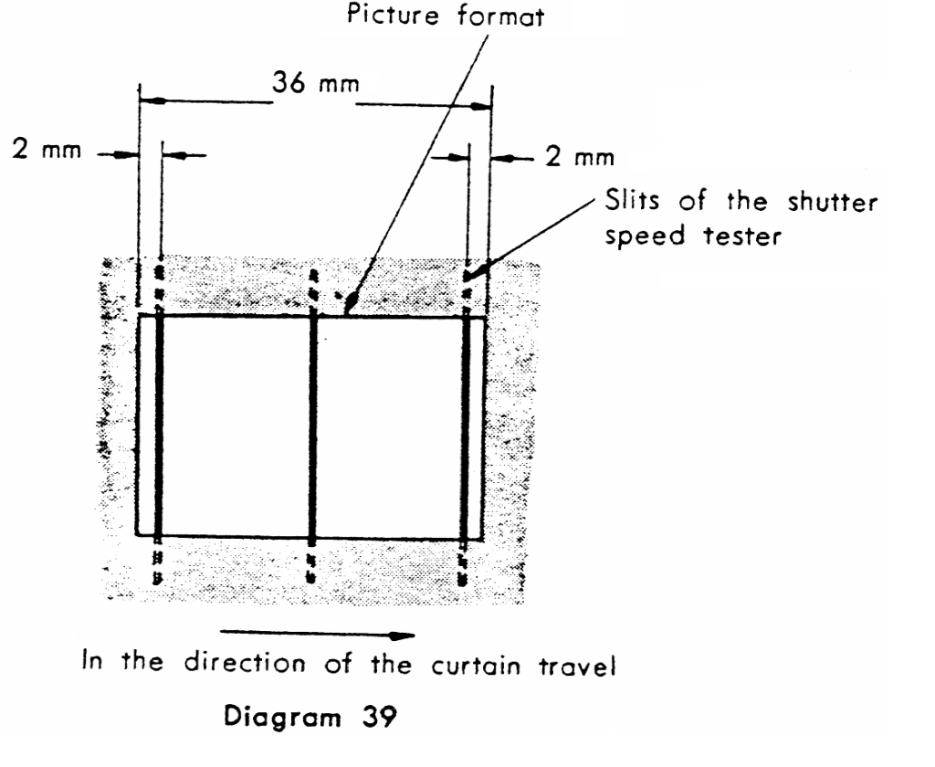

If you look at the service manuals for your cameras, sometimes it will tell how far apart the sensors are.

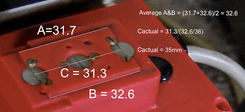

Other times some guesswork is involved:
