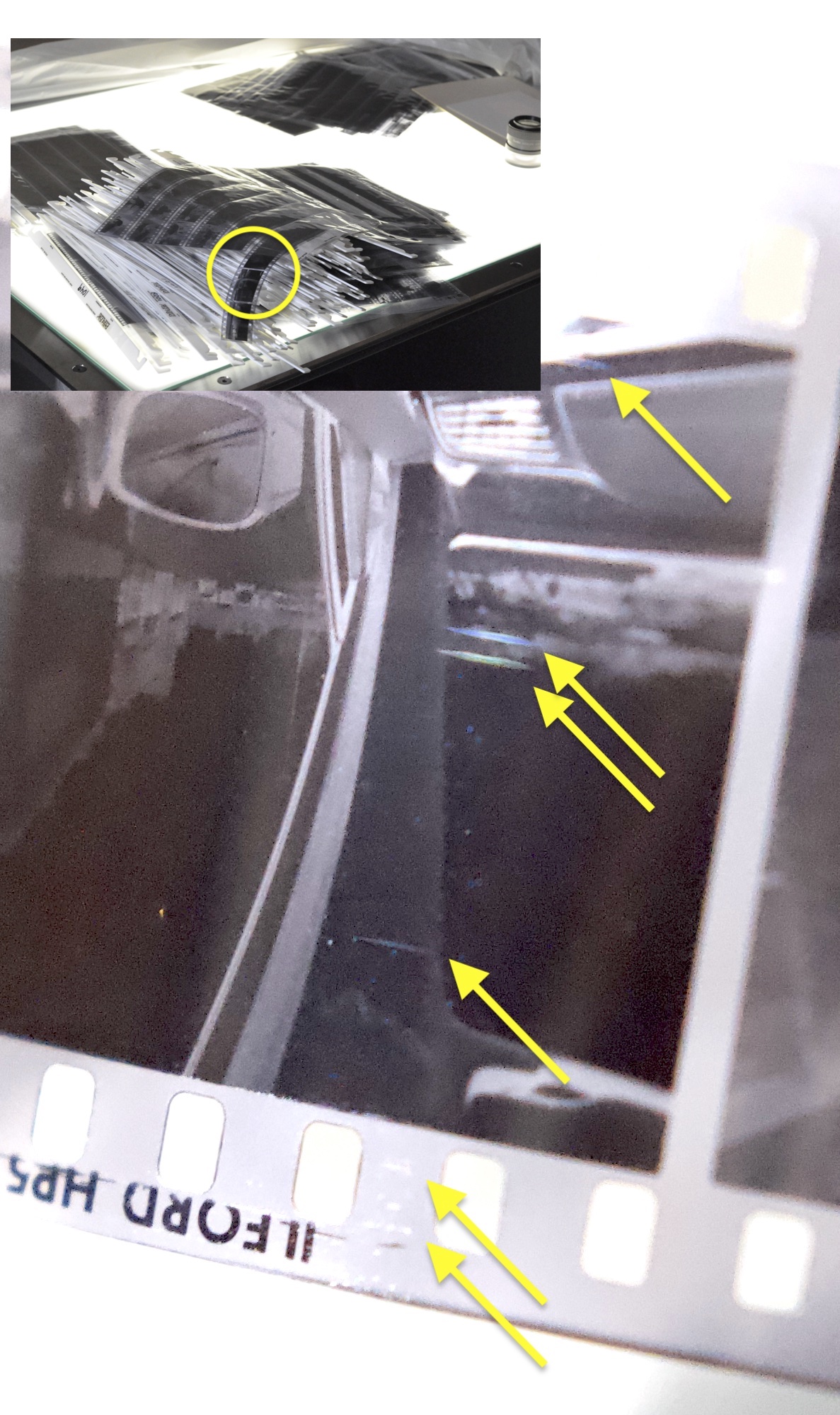

Let us see the pictures! Also, diffusion vs condenser would be important to know too!
See here for a pic of affected film. And no, people will not put such a roll into an enlarger to find out, whether their 5+k camera needs service.
Maybe we can lay this to rest at some point, it's getting ridiculous.
No print in that link. Are you saying the scratch does not show in the prints?
I did a Google image search for M6 film scratches and found none. Must be a pretty rare thing.

So the scratch is like a ghost, it does not show in the prints.
Nobody in his/her right mind would waste time on printing a scratched negative. Since I don't have a Leica, I may be the wrong person to ask for scratched and printed pics. Fortunately there are Leica owners here, who can personally attest to the fact, that the new Leica M6 experienced technical difficulties a year ago.
BTW only a small subset of Leica owners would ever see these scratches on final pics, since typical color processing today includes an ICE capable scanner, which would cover up all but the most obnoxious scratches on film. This leaves only B&W shooters to actually detect these scratches unprepared. The resulting prints would still go to trash, assuming "I probably scratched that roll during processing" or "oh darn my lab scratched the film". Once the internet spectacle broke loose, many new M6 customers inspected their film rolls (including color film), and there's a good chance, that some M3/M4/Mwhatever owners also suddenly started looking. Some of these scratches were probably small enough to be invisible in prints/scans and would not warrant a repair/replacement/return, but I guess that Leica owners have different attitudes and expectations towards small faults and defects than Holga owners.

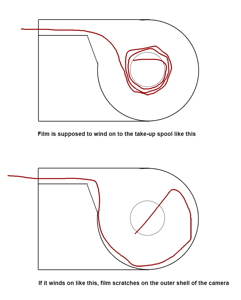

Here's my theory on why some people get scratched negs with Leicas. I used to have a couple of the original M6 cameras that I had to sell in hard times after I had a stroke in 2013. A few years ago, I began rebuilding my Leica kit, but M6 prices had tripled in the few years since I sold mine, so I bought an M3 and an M4-2. The M4-2 has the same loading system as the M6 (and M4, M5, M7, and MP). You stick the end of the film into the take-up spool, which is shaped like a flower, then wind the film. It is supposed to wind around the take-up spool tightly, but I noticed that sometimes, the film slips a little and winds so loosely that it scrapes the inside of the camera, as in the illustration I made below. That will scratch the base side of the film when it happens!

The problem I saw with my cameras scratched the base side, not the emulsion side.
Well, the "theory" you described in post #17 can't explain scratches on the base side. Leicas wind the film with emulsion facing out, so if you actually got scratches from the body shell because of the loose winding on the tulip they could only have been on the emulsion side.
