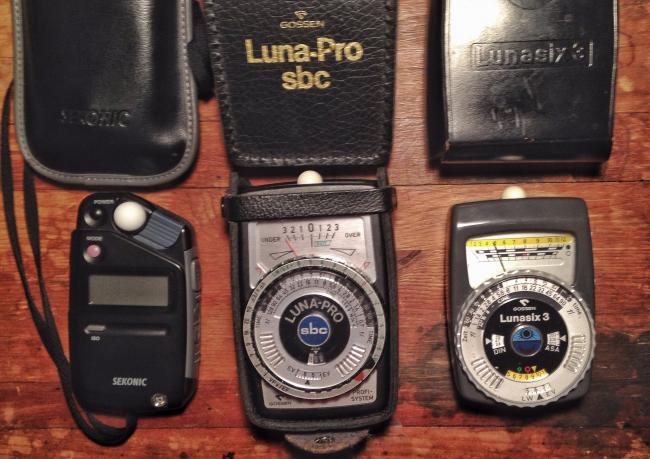

I have a thing for meters. Here are the 3 we've talked about. I also have the venerable sekonic L398, and the small sekonic twin mate. Neither of these 2 meters read very low light. I also have the CV Meter ll which is small enough to mount on a camera accessory shoe.
6 light meters, that's not crazy, is it? :wink:
