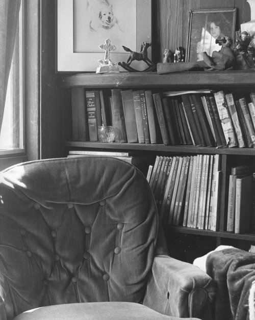

Developing time.
The developing time for FP4+ in the above Pyro-Metol-C-TEA developer (call it PMC-TEA) is 10 minutes at 70 F. The attachment shows gradations, but not the fine grain.
