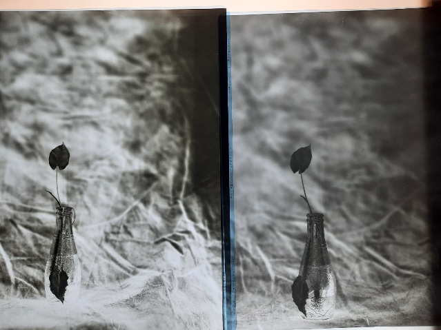

I've been struggling with the almost the same question as you, except for Foma 100 and for salt printing.
I think I can get enough density but it is depended on light conditions. I have to blast full power from my studio flash next to the subject and shoot against black background. I'm overexposing the highlights and limiting exposure to the shadows by directing the flash.
I develop with 2x time in Rodinal and my shadows are pretty much near the base+fog, or maybe the same density.
Next up is to try this outdoors, the spring has sprung here so it is decent time to go out with my 5x7" camera..
My IG has some salts made with this technique: http://instagram.com/vedostuu
