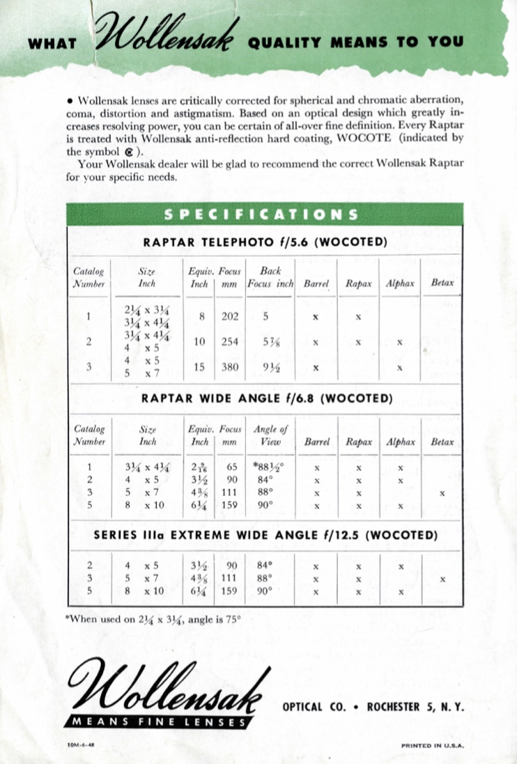

I’m not familiar with a Wollensak 65mm f/6.3, but if your lens is the 6.8 wide angle, then the catalog page below indicates that it was available in barrel, Alphax, and Rapax.
Measure your lens cell threads and see if they are consistent with the Alphax #1 or Rapax #1 shutter mount dimensions available here: https://alphaxbetax.com/resources/
