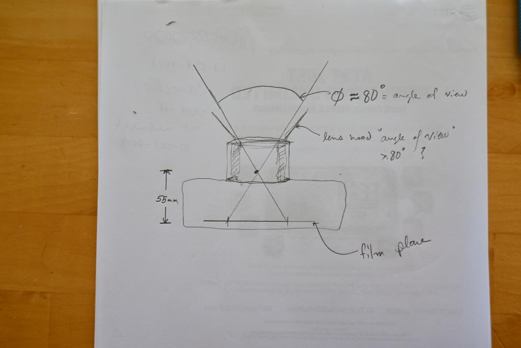

Seems like it might be better to simply get the proper OEM lens hood.
Stacking filters is not good. Each filter will reduce the light transmitted. To see the effect, stack a few on top of a clean white sheet of paper.
Maybe I'm missing something but the math in this case seems deceptively simple. If the angle of view of the lens is ~80 degrees, wouldn't a lens hood with an "angle of view" of (slightly) greater than 80 degrees be what you want?

good suggestions all. I had a similar drawing roughed out to what @BradS posted above.

In @BradS image above, imagine the left and right side of the lens barrel getting longer. At a certain point they cross into the angle of view. The math of this point is all I am trying to avoid with a reasonable guess before I start wasting film.

You basically got the right approach: construct it graphically.
One needs three main points, at center of the edges and at the corner, the location of the principal point, the location of the filter thread. Projections of these points through the principal point are constructed and then parallel and longitudinally shifted from the cardinal point to the thread. From there on you construct the optimum shade.
