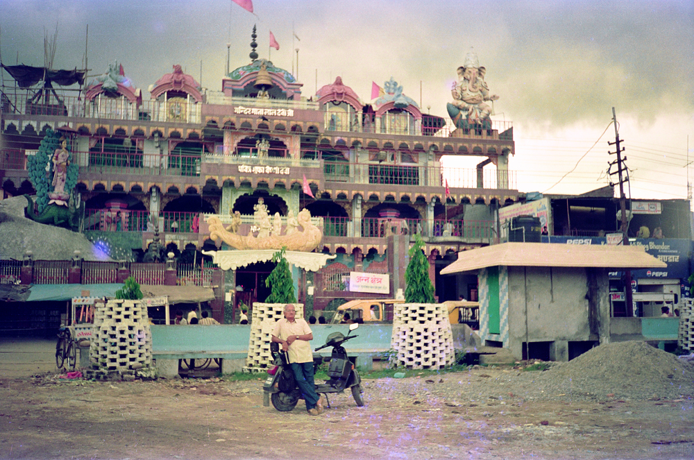

I posted a similar post some days ago asking about the scan quality of some negatives and thankfully I also got my answers. But one more similar question popped up in my digitisation process. As I earlier told I got some of my old C-41 color negatives scanned at 16-bit and set at the highest resolution with Noritsu lab. For some of the rolls the lab didn't got the colors right(Having green tint) and told aging as the reason.

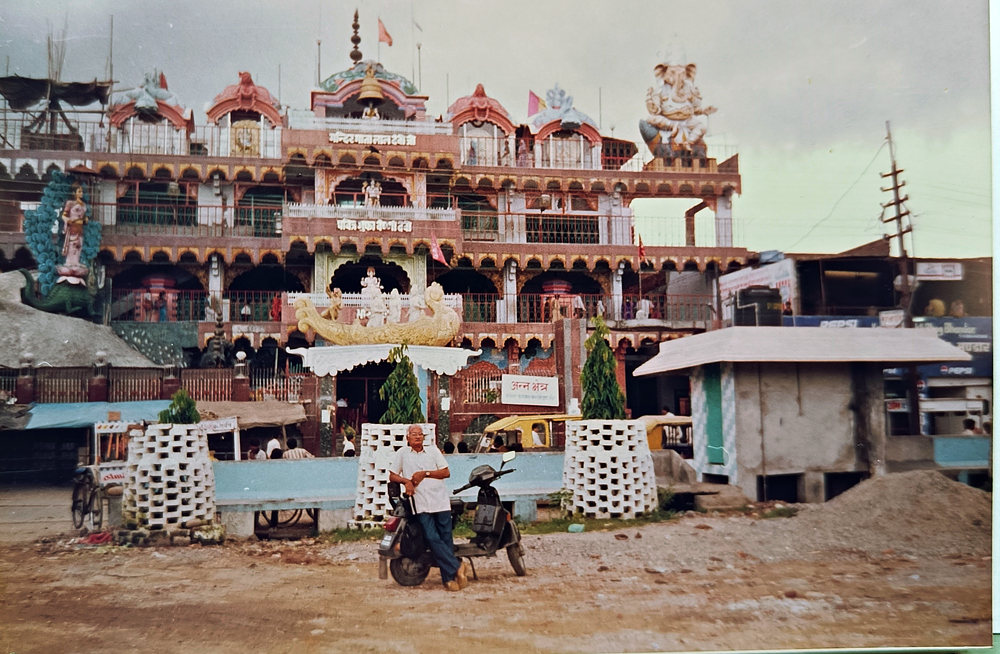

Now I am arranging to get my leftover prints scanned and got confused whether I should get those prints scanned whose original negative scan (Scanned recently and years later than original prints) gave wrong color accuracy results. Because in terms of resolution, the TIFFS of scanned negatives are wayy better but in color accuracy the original prints are 100% accurate. Can someone help me ascertain whether it's possible to easily calibrate TIFF colors to a precise level of original prints? I have very basic knowledge of post-processing and I have no clue.
At bottom is the G-DIVE link. These are five TIFF and JPEGs pairs. JPEGs are original prints shot through a phone camera to give the idea of original colors when the rolls were developed two decades ago. Each pair has the same name except one is starting with TIFF and one is starting with JPEG.

I looked at one of these, and I would not bother with the TIFFs. They're bad. Really bad, with a lot of color crossover that is impossible to fix. I'm a very good editor and the best I could do with it still looked awful. Here's my best result with the TIFF:
The JPEG was actually easier to edit. I got pretty good results with it:
If you want the full-size layered PSD files that I created, let me know and I'll put them on my server and PM a download link to you.

Photoshop. I used curves adjustment layers. Because I was finding that getting correct color in the light tones made the dark tones look bad, and correcting the color balance of the dark tones made the light tones look bad, I had to use some unusual curve shapes, lightening one of the three curves colors (the primaries red, blue, and green) in the light tones and darkening the same color in the dark tones, or vice-versa. All three of the primary colors required this kind of treatment. The TIFF versions that the OP uploaded were so bad that even this couldn't fix them but it worked on the JPEG version, which was not a screwed up.
Thank you very much for your help. I will opt for scanning my prints by reading about these problems with my negatives. Your review of these scans really does matter to me and made my decision to scan prints far easier.

Pushcal, just scan the prints as JPEG, that will keep the process as simple as possible. Ignore the negatives.
Correcting print images is easier than scanning film images.
JPEG loses nothing except when you make multiple corrections. You probably want to increase contrast to compensate for the film's obvious issues
