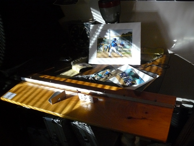

Just to throw this out...
You can build a mat cutter; I did. Here's a snapshot before I turned the lights on. The jig and both the 90 and 45 degree cutters are aluminum angle.
It works well....I don't send anything out to be matted anymore.
