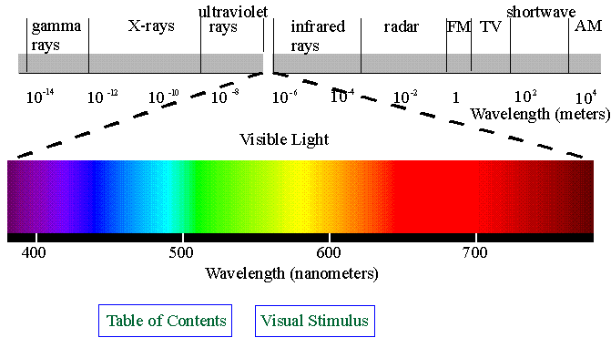

Here is a visual aid borrowed from York Univ.

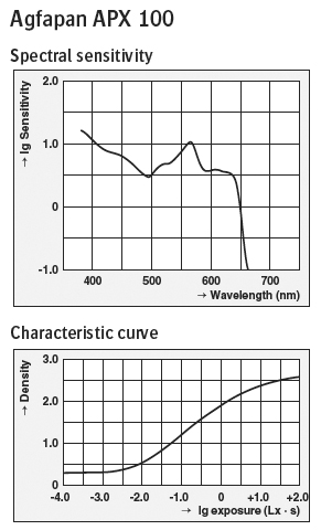

And below, here is the late lamented APX 100 data.
Thanks for the color graph. There is also one in the UV filter link I supplied, although he has the colors reversed from convention.
Wow, that APX is quite the roller coaster, even more than Kodak's general curve.

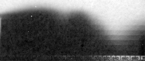

Wedge Spectrogram
Here is a wedge spectrogram. The visible spectrum in nanometers is the x axis and the Log E values in 0.3 increments is the y axis with increasing speed moving upwards and increasing exposure downwards.
This is a green sensitive material. The peak in the red region is a harmonic of UV light, as this was done with a hand coating on a spectrosensitiometer with no UV filter.
As you can see, the visual slope varies as a function of wavelength in this case. If it does (It does not sometimes and does other times depending on dye and emulsion), the singe line curve in the example above and shown on Kodak's site are not revealing. You have to construct a curve at each wavelength from the entire exposure such as shown here in the data I have included.
The line drawing of spectral sensitivity is just an approximation unless you know the full curve.
PE
PE, when you showed us one of those in your workshop here in New York, I finally understood why a safelight works.
