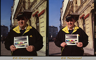

I have made much comparative samples of color reversible process E6.
I used Kodak E100GX two films that were exposed identical.
Mamiya medium format camera.
A film I developed in the process compatible E6 (George).
The other film I have developed in the original E6 Tetenal proces.
Scanning two frames (E6 George + E6 Tetenal) I did on the Epson V800 as a single photogram.
The scanned image without any correction was not further processed.
https://www.flickr.com/photos/21121448@N06/30599998764/
In my process E6 compatible I used in color developers CD 2 substance.
George
George
Multumesc pretenul!!
So you have created an E6-compatible process using CD2? Interesting...
But i wonder, why? Is CD2 cheaper?

Yes, it is a process compatible E6, to play back with more halftone image, especially in white.
By 1977 when I started with color photography in Romania was on the market only Orwo Chrom films - UT 18, UK - 17.
These films give a picture about contrast and with the blacks cold.
So this desire was for a long time.
I do not know now tell you if CD 2 was most cheaper than CD 3.
I used CD 2 was better photographic results.
When you prepare yourself solutions is inexpensive process.
George

George, AFAIK these old Orwo emulsions used a process of their own, and this process uses CD-1, which in turn is very similar to CD-2, but not CD-3. Therefore I am not surprised, that these Orwo emulsions worked better with CD-2, and at the same time I would expect modern slide film to work better with CD-3 than any other color developing agent.
PS: CD-3 and CD-4 are less critical with respect to allergic sensitization of your skin, therefore I would prefer these two for health reasons.

Rudeofus, process for reversible color films ORWO was 9165.
I have ORWO FORMULAE - 1982 edition.
Orwo Instuction 9165.
In the color developers ORWOCOLOR 17 use Diethyl-p-phenylene diamine sulphate (TSS).
You call it CD-1.
George
You call it CD-1.
AFAIK the terms CD-1, CD-2 etc. were coined by Kodak, and since they were the big game in town, these terms stuck. For equally understandable reasons there were different terms common at Agfa, and yet different terms in Eastern Europe. In the end, it doesn't matter, as long as we have unique ways of specifying compounds.
As you can see, CD-1 and CD-2 are very similar, and there is a good chance that both will yield very similar results, with better archival stability if you use CD-2. CD-3, however, is a different animal, so watch out if you substitute CD-3 with CD-1 or CD-2.
