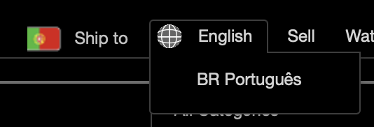

When using eBay and you're logged in (which you may be, automatically), be sure that you update your location to Portugal. Otherwise eBay may filter your results based on your profile location, which may still say "US" (as it also says here on Photrio).
hiroh
Dec 30, 2021
319
Lisbon
Check the ebay store I gave you, it is located in Europe, sends all over Europe, and sells lots of Durst stuff.
I checked, but there are lots of enlarger parts and only one complete Leitz enlarger. I also looked for easels, but none of them are adjustable on all four sides.
My eBay is set to Portugal.
