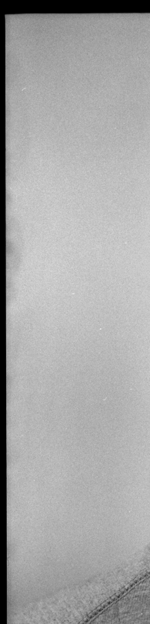

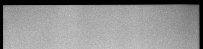

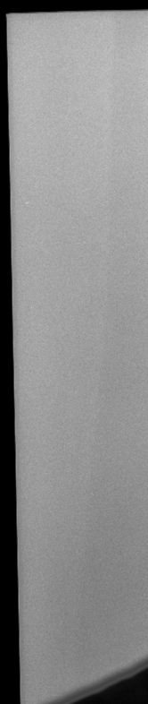

Hi everyone,
I've been having problems with my negatives. It seems that the emulsion side is always super clean but there's something like water leak on the shiny side. It was worst before when I was using too much photo flo but it's still not perfect.
The pictures are portrait on a white background but I changed the brightness so you can see the lines on the negative. Its normally more visible on blank surface like a sky or a background.

These weirds spots on the side of the negative appear often.

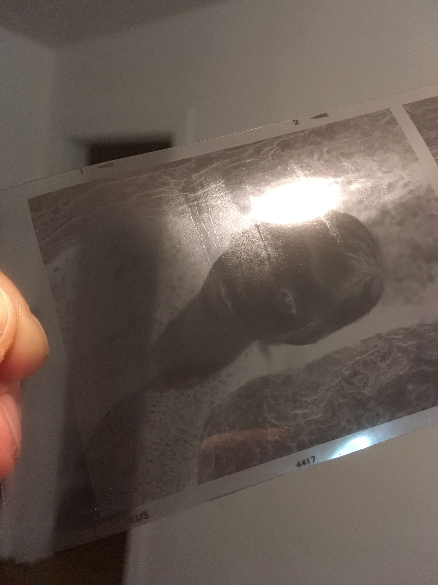

This is the worst example that I have. It was like this when I was using too much photo flo but as you can see the leaks are not vertical like if it would be water that slide on the negative when they're hanging. I tried to remove the line with isopropyl alcohol 90% but nothing changed.

If you re-wash the film, does the streaking disappear? I would try a bit more photoflo. I use 1/2 capfull for 1-2 reel processing tank. Also, you are over fixing. 2-4 minutes is adequate.

Dear vncnt,
I add one more step. Once I have the film hanging, I pour the photoflo over each side of the film. This seems to wash away any excess bubbles and such. I can't take credit for the idea as I picked it up years ago either on this forum or the old Compuserve photo forum.
Good luck,
Neal Wydra
