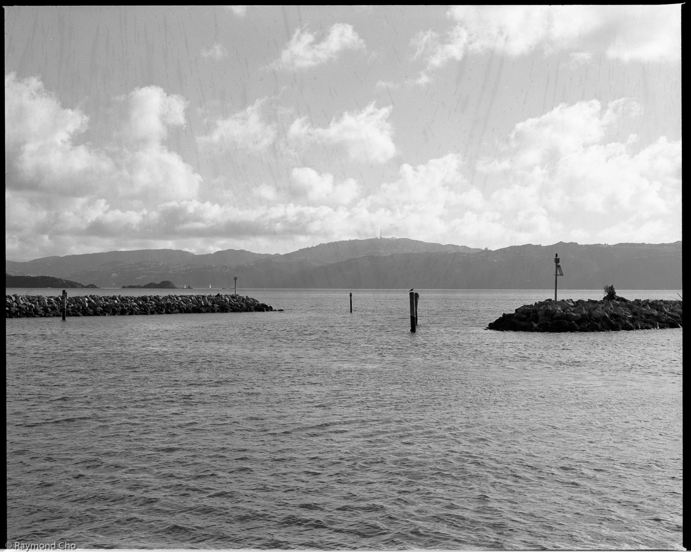

Hi all
I developed some Ilford FP4 125 in fresh Ilford ID-11 1+1. The film was bought from someone at my camera club which is expired but stored in fridge. I had 9 rolls in the same batch. Never seen this before. I developed them inside a large Paterson tank. So 2 rolls together of this Ilford FP4 stuff at the same time, the other roll had no issues. What can the marks be due from? Could it be the sticky tape that had made contact with the film as I was loading it? Camera was an RB67.
Cheers

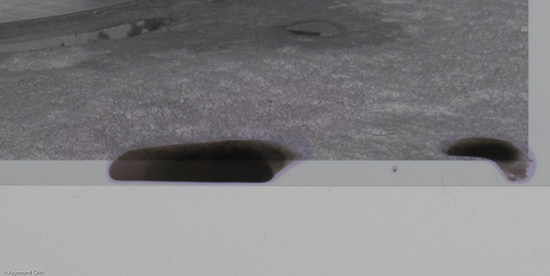

Here is another frame which I gotten some residue. RB67, Fuji Acros 100 the first version developed in ID-11 1+1. I haven't done the developing any differently it was also developed in a large Paterson tank with the white plastic reels. 2 rolls developed at the same time together, the other roll came out fine without issues. Fortunately apart from this first frame, the rest of the roll was fine also.
Cheers.

Re: the second post the image is posted underneath. Is it some of the liquid got trapped in the developing reel? Was it the way how it dried? I hanged it up with a laundry peg on the bottom so it was held straight.
I just mentioned about the developing tank to give people more information so they can provide some feedback.

Concerning the first type of artefact, I have not seen such before. And I find the two respective explanations given by Shutterfinger not convincing in this case. Concerning static, the respective artefacts in the images I have seen were different, though I have come across similar patterns at dust layers, seemingly static induced.
I am clueless.

The artifacts on the 1st film have the characteristics of liquid streaks. How much agitation during processing and fixing? Wiping before hanging? Do you use photoflo?

In the second issue, the film was tight against another object at those spots, like when the film is reeled wrong and overlapping, so the developer and fix don't quite get to that location. Does the first issue look like uneven development caused by not enough developer in the tank?

That's to do with your fixing, those areas developed OK but hadn't fully cleared. You can get air bells in fixing as well as developing although usually not an issue.. You don't say how fresh your fixer is/was.

I'm sure it's not the tank at fault, you can see clearly the negative developed OK in those dark areas. I think top edge of the top roll in the spiral and insufficient agitation and not quite enough volume, I always use just over a litre for two 120 reels.
The lines on the first are probably slight surface scratches to the emulsion. Acros has a significantly softer emulsion compared to many other films, PE speculated it may use Whale Gelatin. The direction of the lines also give a clear indication that they are in fact scratches.

The first photo is off a scanner but yes I do see the same marks on the actual negative.
The second photo with the blotches on the bottom is the actual negative. The photograph was taken with the film on the lightbox with a modern D camera.

I used a Paterson Super System 4 Film Development Tank. It does up to 5x 35mm reels. I used 2 120 sized reels. I used 1000ml of liquid for all my developer, stop bath and fixer. Maybe I should use a bit more? I also used a white round clip that goes above the reels on the black spindle to help hold my reels down in place.
Ian
The fixer is dated on the bottle 09/2019 by the manufacturer or the store. I first mixed it up for my first batch. I did my first batch in March 2020 and the second batch was October 2020 which I disposed of it and mixed up another 1L. I usually do up to 6 rolls and I dispose and remix. The first photo and second photo in question here are from my October 2020 sessions. 1st session is the first photo here (FP4 125), the 2nd session is my second photo here (Acros 100).
Ian
I will use a bit more liquid next time. I shot 2 rolls of Acros one on the RB67 and one on the 500CM, and I developed in the same tank at the same time. A bit at a loss to why. The other Fuji roll came came fine. Perhaps I just loaded it differently in the wardrobe and it affected the film or it was how it was loaded in the camera .....

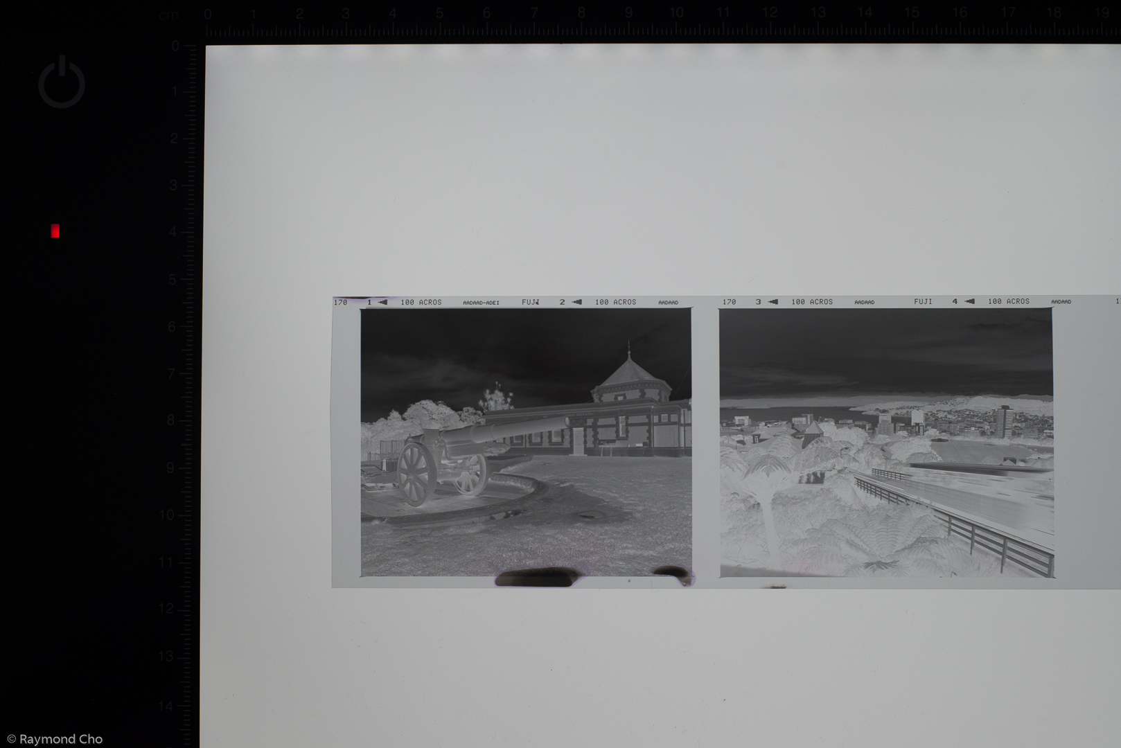

Maybe it is true bubbles maybe? Re: the 2nd posted above photograph (RB67). This below is the other Acros 100 roll I developed (500CM) at the same time. I get these marks on the far left and right sides. I will try to use more liquid next time but the 1L has been a convenient size to use without wastage.
