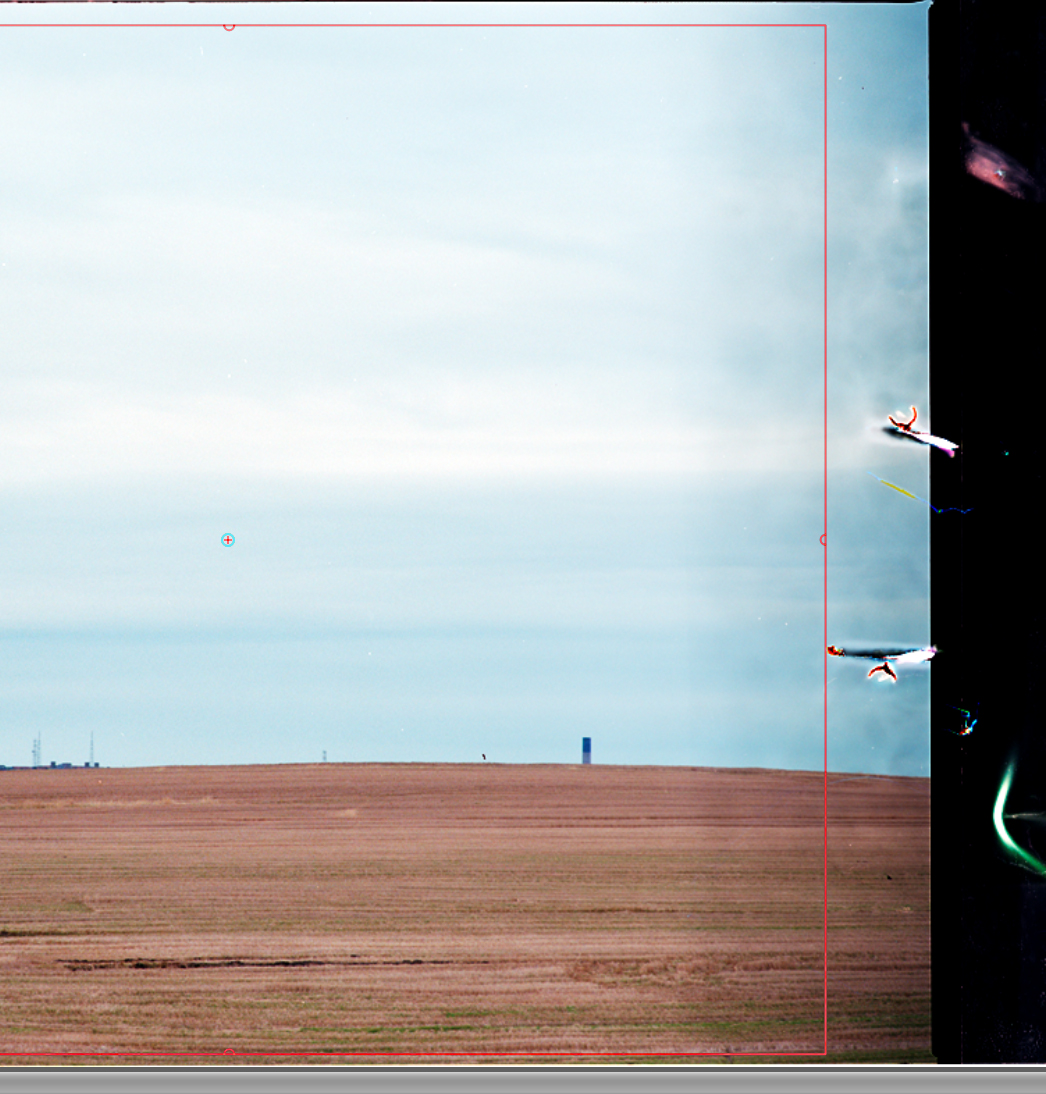

Please see attached image...
Not getting it all the time but there are two deep teeth marks dug out of my last frame. Anyone ever had this or know how I'd avoid it? I'm assuming the mechanism in the back just slipped or dragged it through but I'd rather no waste a frame when possible.
Cheers

Got the film developed at a local lab here in the UK. They're usually first class for quality and so I'd assumed these marks were from my camera rather than them processing.

I use a manual winder. Can't see how the back could have done this the more I think on it. It's not a major loss as that final frame wasn't my best, just don't want it happening again!!

That last image seems awfully close to the end of the film. My RB67 (not RZ) tends to give me more to work with at the end. How much blank film is at the beginning of each roll?

Yea it's an odd one that. Does seem very close to the roll end. Maybe a mistake when winding it on at first? Usually there's more left over...

Talk to the processing laboratory. It looks like they screwed up. Bring it to their attention so that I will not happen again to any of their customers. They might even give you a roll of film.
