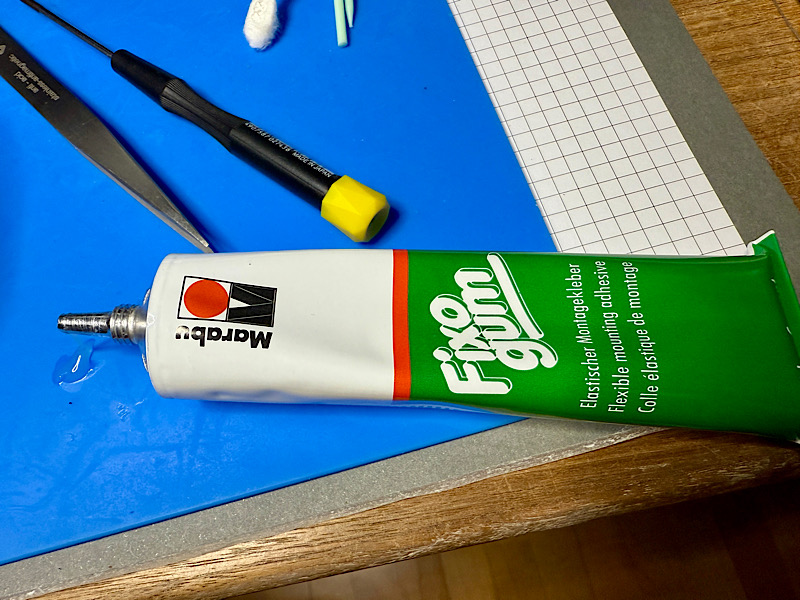

Since my tube of Pliobond is almost finished and the adhesive is apparently unavailable in Europe, I'm looking for an alternative. I want to use it to bond leatherette and anything else that needs to be removable during repairs on cameras.
The description of Fixogum Rubber Cement sounds promising:
Elastic adhesive for graphic design and craft use. Glues paper, cardboard, paste board, plastic film and other flexible materials. For non-permanent or permanent fixing. Glued parts will not deform. Does not ripple the paper, ideal for photographs. Any adhesive residue can simply be rubbed off. On the basis of natural rubber and organic solvents. Not resistant to ageing. Acid-free.
As soon as I have a tube of it I will report on my experiences.

Today I used Fixogum to glue the leatherette on the bottom and the screw cover on the eyepiece of a Canon T90.
The adhesive is easy to work with; it only leaves moderate threads and dries quickly.
For a stable bond, I would apply it to both surfaces.
Residues can be completely rubbed off.
I'll stick with this adhesive and gain further experience with it. In particular, I would like to check the strength of the bond.
