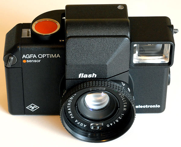

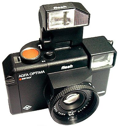

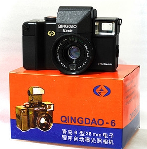

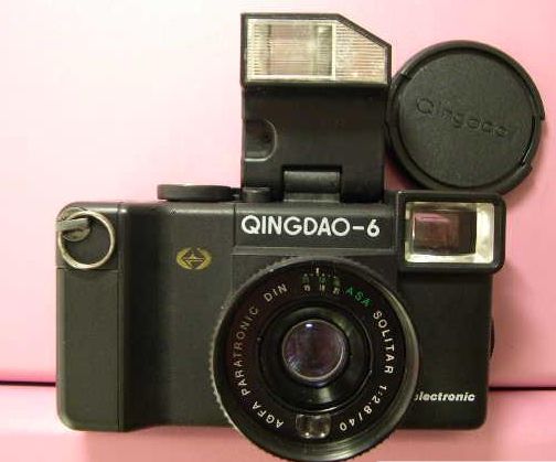

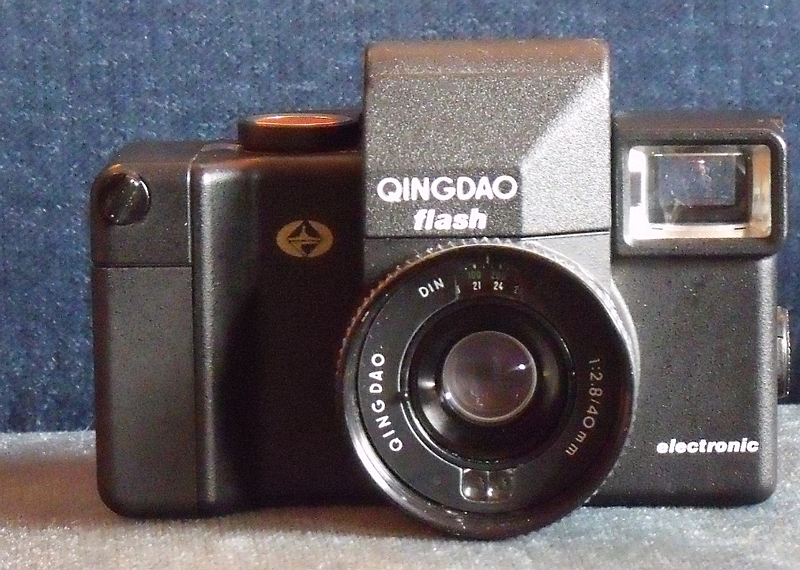

Take a look at the photos.

You are ridiculing again.
The Agfa Optima sensor is a camera of great design. Very similar to a camera praised here at Apug, Makina. (Who copied whom?)
Furthermore it has the best viewer of all finder cameras. A Albada viewer that beats any brightline viewer.
What you did is looking for the rare version with built-in flash that indeed is design desaster.
Concerning manufacture:
As you see the models are not identical.
Furthermore it was not uncommon for a german manufacturer after a model was outdated to sell the tools etc. to an asian manufacturer for production for the overseas market.
There also was copying of german design.
Concerning this very model,
there is a site (the only source I found for one of the photos you presented) that just confirms my general statement on follow-up production for this model.
Dead Link Removed
