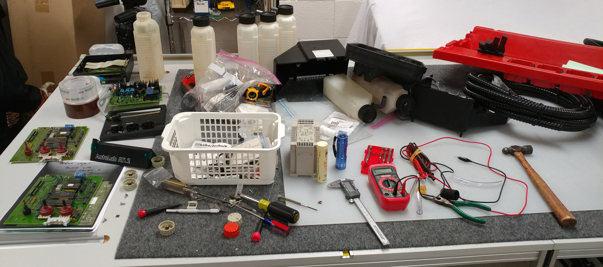

Hello to all.. it has been an interesting path with this Jobo ATL-2. Being the person I am since my last log on I have been able to compile enough information about the ATL to really roll up my sleeves and get right down to the last stainless screw holding it together. It processor is now clean and starting to go back together. I have hopes to do a wet test by this weekend. It has been a challenge finding some of the parts and two parts critical parts that do not seem to exist I needed to fashion the repair to make that part functional involving form, fit and function. I also think I found all the damaged circuit traces and damaged discrete components that were going to impact the operations of the controller boards. I will log back in later this week as I get further along .. I sincerely appreciate all those who have reached out and put me onto some of the information that helped find additional the additional information. I will post a link to where I was able to obtain a fairly complete service manual as soon as I can remember where on the world wide web I stumbled upon it...

The fact alone that you got a hammer lying at your workbench tells me that this all is no easy endeavour...
Yah .. .. it needed just a little "tad" of friendly persuasion with some glued parts that were not part of the original assembly... The person who did all this botching to this ATL should never be allowed to own any kind of photo processing equipment.. every!
