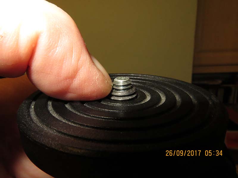

I've just acquired a Manfrotto monopod without a 'head' thinking I could buy a ball and socket later, only to discover it has an unusually big screw that doesn't seem to fit any 'heads' on the market. Any advice what heads will fit, other than manfrotto's that will probably be very expensive

My Manfrotto monopod has a 'two-ended' mounting screw. One end is the US Standard 1/4-20 thread, the other end has a larger 3/8-16 thread. Just unscrew it from the tripod bracket, turn it over, and reinsert.
Just looked at the tripod again. The actual opening on the adjustable tripod bracket is the larger thread size. The insert that mounts the camera to the tripod has the larger thread on one end. The 'collar' of the other end is the larger size, while the end of the side is the smaller size thread.
Are you perhaps missing the adjustment/mounting screw?
Taking off the adjustable tripod bracket, the actual screw on the end of the tripod proper is 1/4-20
All Monfrotto tripods/monopods have standardized tripod screws. Keep in mind there are two sizes of threads: 1/4th" and 3/8th".
Large 3-D heads for instance use the large thread.
Your monopod has 2 coaxial screws.
The outer one is springloaded.

My Manfrotto monopod has a 'telescopic' 3/8" thread over the standart 1'4" tripod screw thread so either option is available.
Mine doesn't - it only has a 1/4-20 - so it appears there are at least two different monopod models (mine says 3006)
Edit: I just looked at the US Manfrotto website and there are over a dozed monopod models!

How ingenious. I've had a closer look at the 'big' screw and it does seem to be covering another smaller threaded screw...but how to unscrew the screw seems to be the problem without damaging it?
