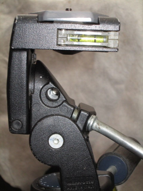

On the pan and tilt head is a screw hole just above the horizontal pivot.
Pictures on the internet show a chrome, knurled screw inserted into what seems to me to be a blind hole. I wonder if an accessory bracket may screw into the hole. Just a guess.

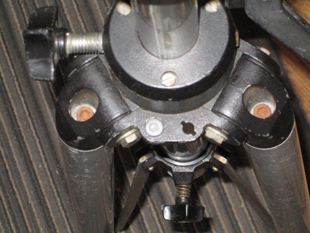

The other unknown is a hole drilled into the tripod about half an inch away from the spirit level bubble.
The hole also has a slot cut across it. It looks similar to the symbol put on the top plate of some cameras to mark the film plane.
Thank you in advance to anyone who can reveal the functions of these two oddities.

I don't know about the slot & hole on the tripod, - it might be to hold a pin of some sort for the centre column.
The threaded hole in the 029 Pan & Tilt head is to house a 3/8 inch brass bolt. The Hex plate comes with the smaller 1/4 inch threaded bolt for most smaller & medium sized camera bodies. However that can be unscrewed through the centre of the hex plate and the locking collar, and replaced with the larger 3/8 inch brass bolt, for situations where you have a larger camera body that uses the larger size tripod mount. It's convenient to have, but not exactly essential. You can just have a second hex plate with the larger size thread, or use a thread adaptor that costs nothing.

Thank you for the fast response.
I would never have guessed that in a month of Sundays.
The tripod did not have a hex. plate when I bought it so I ordered a Chinese one from ebay.
Around eleven pounds each, delivered within the week.
The 3/8" one ordered later is yet to arrive.
Looking at the screw I now see how the extra is stowed safely.
Nice one.

The hole on the tripod might be there to hold an Allen wrench just like the one I find useful for keeping things tightened on with my Manfrotto tripod.
