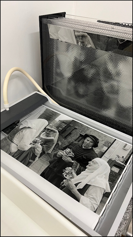

I use a Paterson tray washer for the first few minutes after fixing: as well as sluicing off the worst of the fixer, it gives me a chance to take a good look at the print and decide whether changes are required. I wouldn't be without it now.
I usually just put my prints in a 'holding bath' in another tray full of water until I'm ready to wash them, but I like your idea of a pre-wash in a Paterson washer.
