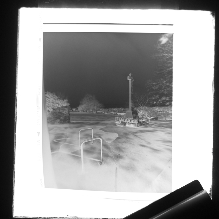

well, here's a clip test at 10' 45" (still wet)
With a certain serendipity I managed to clip exactly one frame in total darkness from a curly roll ...
this looks like it will print ok, and perhaps even scan ok (my scanner has a problem with very dense negatives)
The diagonal stripe in the sky at top right is a spreading contrail by the way, not uneven development
