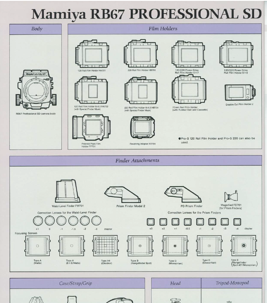

tedr1
Feb 3, 2016
940
50 miles from NYC USA
You may be right, I don't have hardware here to verify, however the documentation, copied below, shows different part numbers for 120 and 220 film holders. upload_2016-7-17_15-38-19.png
