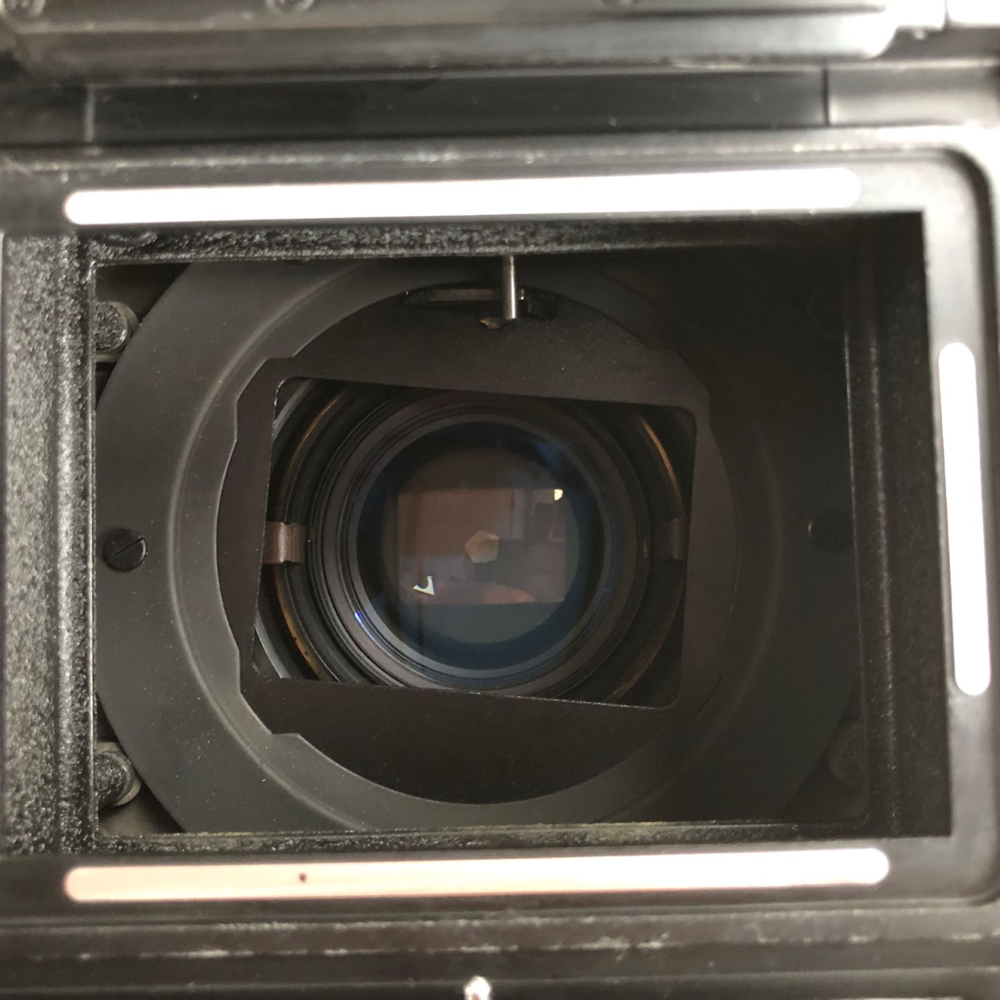

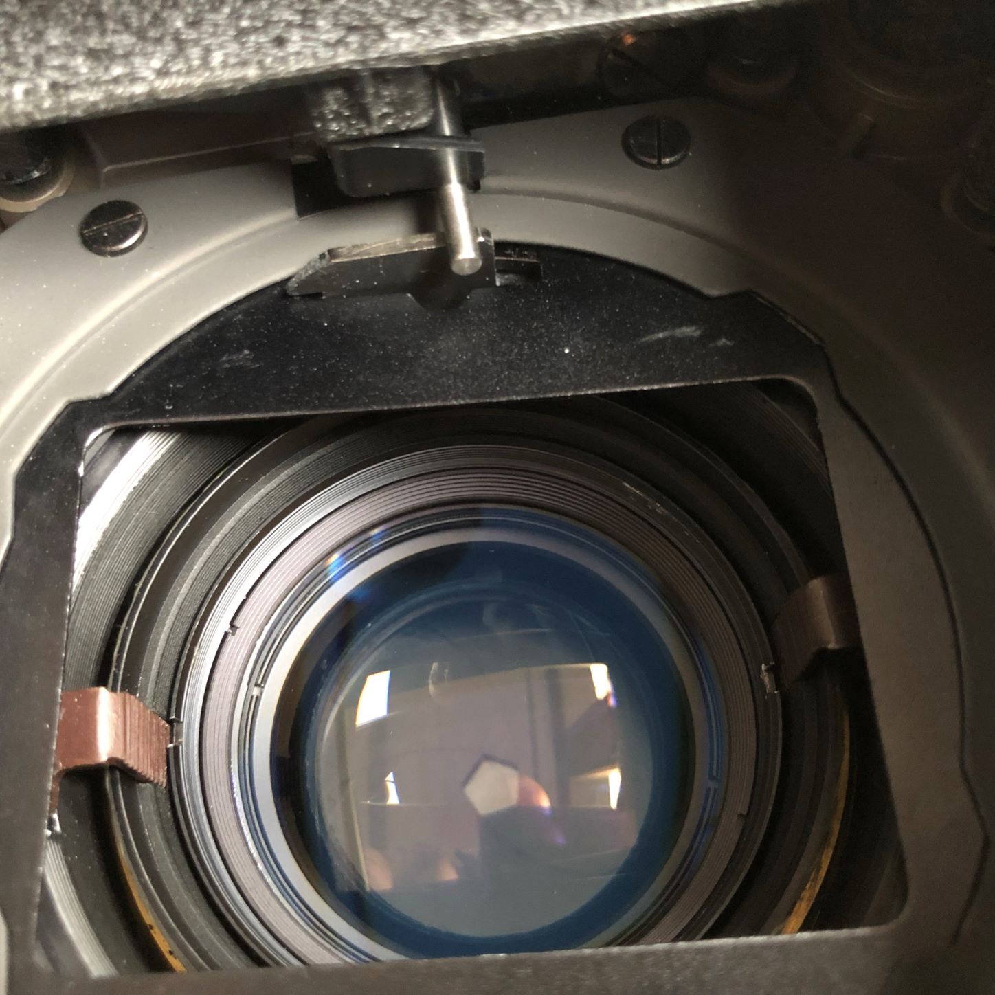

Thanks for your help. I've done what you suggest and I've attached a few photos. The rangefinder coupling pin seems to move back and forward ok - not exactly smoothly but returns ok. On the lens what is, I presume, the RF cam definitely doesn't follow focus. It does stop before I get to the minimum focus distance. So, it appears the RF cam is not set up for this lens? Maybe? Unless you can see soemthing else amiss. The other thing that strikes me is the lens doesn't look straight on - see second photo. Not sure if that's a problem? Thanks again.

From your photos I can see that the light baffle on the rear of the lens is either loose or glued down incorrectly. The rangefinder cam lip is catching on the baffle and not allowing it to fully retract into the lens when focusing close..

It's fixed not loose so glued down incorrectly. I presume thats why it doesn't sit straight ( as in the 2nd photo)?
So, if it's glued it means it can't be straightened without causing damage?

Ok thanks - there seems to be a loose edge at the top so I'll work from there. I do appreciate your help. Cheers

The crooked rear baffle could also potentially vignette the corners of the image (I don't know if this would be visible on a 6x9 frame), so it should definitely be repositioned.
To clarify my previous comment about the "brass ring" rangefinder cam, some of the Mamiya Press lenses, mostly shorter focal lengths, have the cam surface as a ring at the rear of the lens that rotates as the focusing helical is turned. Others have a tongue that is driven in/out by a helical, turned by the focus helical at the correct rate to move the rangefinder coupling. Yours is the second kind. The 150mm lens is also like that.

I’ll attempt to take the baffle off today and straighten it.

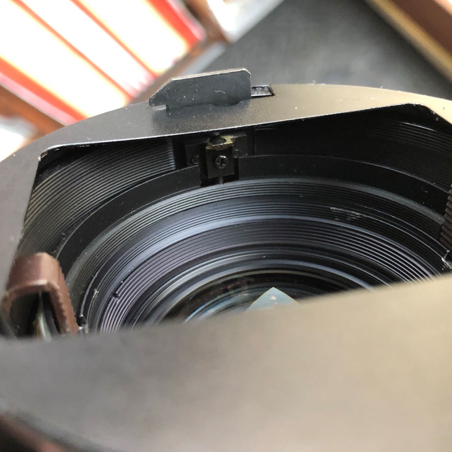

image1 (1).jpeg image0.jpeg Not sure if this is of any help but just snapped a couple photos of my 2.8on a Press Universal

Yes, that is useful thanks. I’ve sorted the light baffle out - the glue hadn't had time to really set so it came off fairly easily. I’m out today trying the camera so i will have a better idea after processing the film. Thanks for the advice and photos.
