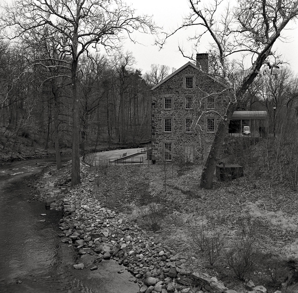

There are so many ways why you aren't getting the sharpness. Is your system focus properly calibrated? Haze and dust in the lens elements? How did you get it printed? Optically or digitally? This was shot few years ago when I had my Mamiya c330 with the 65mm lens. Shot in Kodak Tmax400 and developed in Rodinal and digitally scanned with my 16mp dslr...can't afford a Nikon Coolscan though.
lake-dslr scan by vracing, on Flickr
chip j
Oct 26, 2012
2,193
NE Ohio
Love the shot, but I need to look at a silver print from an inch away to be sure.
dynachrome
Sep 16, 2006
1,846
That looks like the mill on the Bronx River at the Botanical Gardens in The Bronx. Even if all the lenses we are talking about are sharp, a 16X20 will look better (minimal cropping in each case) from a 6X7 negative than from a 6X6 negative cropped to approx 6X4.5. The difference in quality might be caused more by the grain of the film than by the sharpness of the lenses. We don't always know what size enlargement we will want to make from a piece of film but if I know ahead of time that I will need a 16X20 I would choose a 6X7 camera over a 6X4.5.
