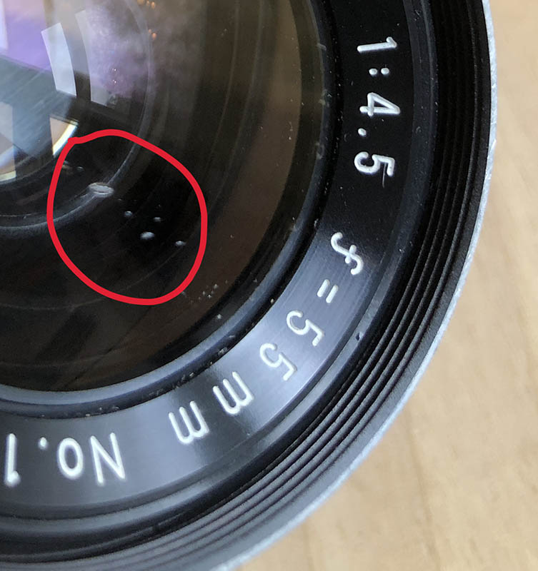

Not sure how big your peck is. But many old lenses from the 1930s and 40s and before have bubbles in the glass. Which look like defects, chips, etc. until you take a magnifier to them. If companies like Zeiss and Kodak were fine with small defects straight from the factory, I doubt a single mark on the front will make a difference.
HI Dan,
Yeah, this is most definitely a peck and few lighter scratches, digs, or indentations. They are tiny as you can see, so I agree, I don't think they will make much of a difference either.
I have a few really nice older lenses with bubbles - such as an all manual black Zeiss Biotar in M42. These were once considered marks of optical quality.
Here is a pic of the condition of the lens:
Best,
Paul
One approach for this kind of situation is to blacken the pecks with a fine Sharpie marker. It might be temporary but it should be effective. That, and a lens shade.
Thanks, Brian - I have done that before - works well. I have found old fashioned India Ink works very well too, and is perhaps a little more long lived. The lens shade is absolutely a must with or without pecks!
