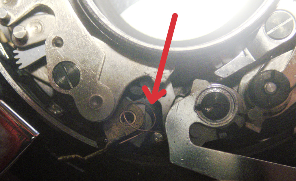

DIY idiot here. The lens on my Mamiya C220 was in pretty good shape -- the glass is perfect -- but the slow speeds were getting unreliable. It's the 80mm f/3.7 with a Copal shutter.
So I decided to take it apart. And I lost a part. Sigh.
Does anyone know where you can get random parts for these shutters? Or of someone who rebuilds them?
Seems a shame to throw away a good lens just 'cause a tiny spring went astray.
TIA :smile:
[edit] added the photo, taken pre-catastrophe

What is the actual shutter? And which spring? Most shutters have more than one spring. And many shutters were used on a variety of lenses so you can find organ donor bodies elsewhere.
You might contact Flutot's and see if they can help. https://flutotscamerarepair.com/AboutUs.htm
You can get music wire and make your own in many cases.

Sure you can re-purpose springs from common objects, but that takes a bit of luck. There are a number of parameters; each with more or less margin of tolerance: length at rest, stiffness, available space... And some are not found in the wild, like some hairpin springs, e.g. the one that allows the main ring to go past the shutter blade actuator when cocking, and to catch it when moving in the other direction, when shutter is tripped. To replace such a spring, I once had to source (at great shipping expense) some 0.1mm (4mil) piano wire.

Please post a picture of the shutter's insides and don't throw the lens away! I have some parts for Mamiya TLR shutters, but the donors I used were all Seikoshas. Still, it's worth thinking about. And like Bernard L, I have acquired some spools of piano wire which I'd be happy to share.

Thanks for the rest of the counsel, too! I'll check out your sources. And the piano wire advice I'm getting sounds pretty good! The spring's pretty simple. (And don't know why I neglected to post the photo last night but it's up there now.)

Just posted the picture I took while disassembling it...
And I don't know the shutter model precisely. Unfortunately, that information seems a little scarce. I was looking at info for the common Copal #0 shutters etc. but they're way different...

So now, with the picture, I'd say (a) looks like 0.1mm or 0.2mm diameter wire. Not something you'll find in a guitar shop; (b) looks fairly easy to duplicate, maybe a small drill bit for the main curve, and tweezers for the hairpin loop.
Like Tel, I'd be happy to share some small-diameter piano wire; he resides on the same continent as you (EU here); Just say.

The Copal shutter used in the Mamiya 80mm f/3.7 lens was a Copal AB323 which would be a "00" size shutter. The part you are asking about is the sync contact spring made from a copper alloy for maximum conductivity. It is used in that shutter only, the "0" and "1" sizes have a different sync spring. If you DM me I can help as I have most all parts for Mamiya shutters.

I had a rummage through my spring parts bin and both spools I found appear to be .009" steel. Looks like Bill (Mamiya_Repair) has the right stuff to fix it.
