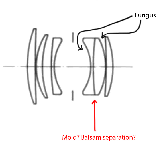

Can you point me to which tools I need exactly? I have ordered a Lens Spanner Wrench, but I'm not sure which rubber thing I need for the rear element.
And I am wondering, can one get access to all glass surfaces in the rear element? I've made a small graphic with what I see with flashlight, but I am not sure I can get access to all those surfaces. The red part seems the worst. If I fail, I will 100% let you work on it. Do you live in Canada?

Post a pic of the lens, that might help. You may want to find a cheaper lens to learn these skills on. If there are issues in the cemented pair, internal to them, that may not be feasible to fix. I Am in the US. It should be possible to access all the surfaces, except any cemented surfaces, which it looks like there is only that one.
