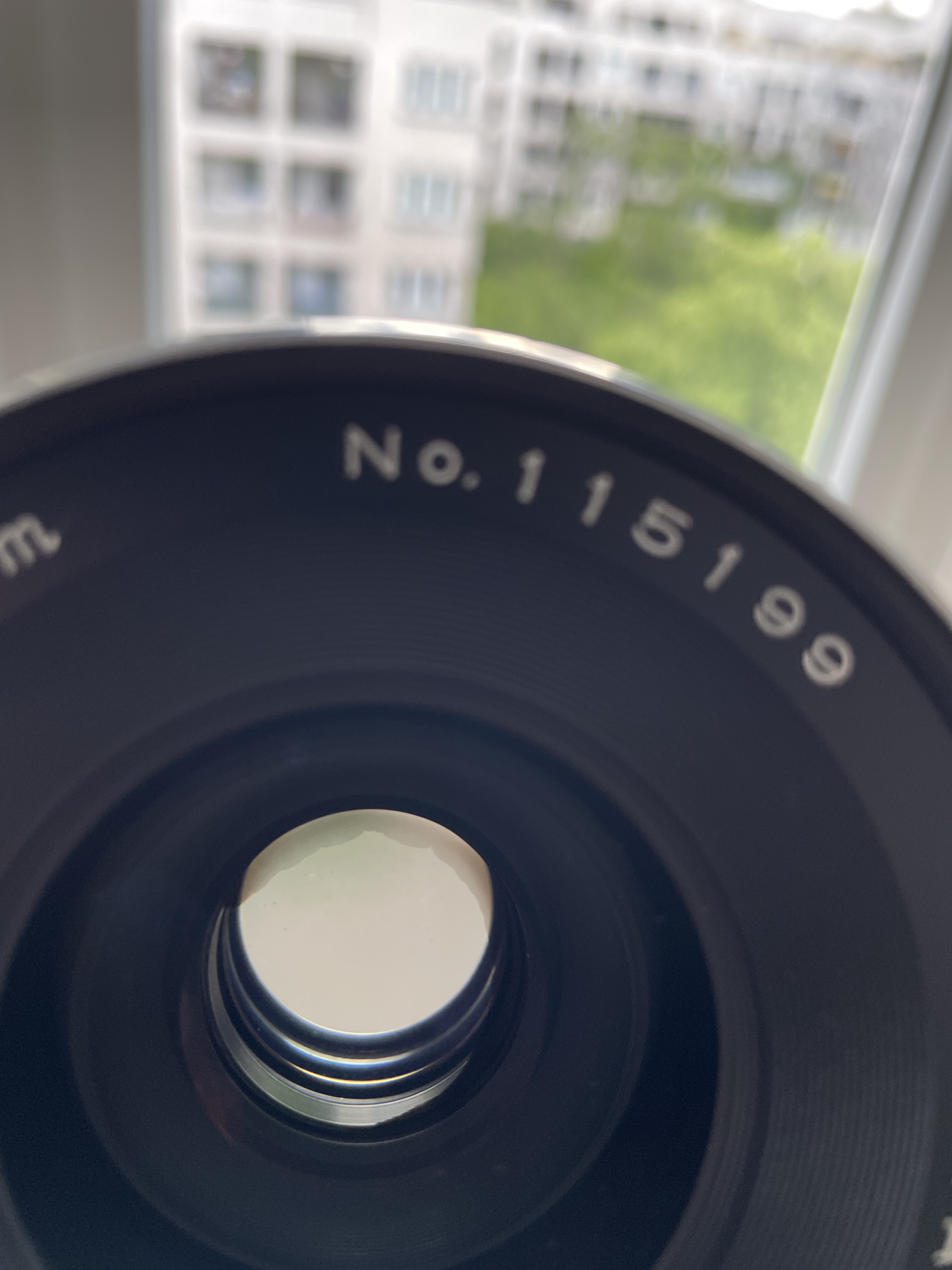

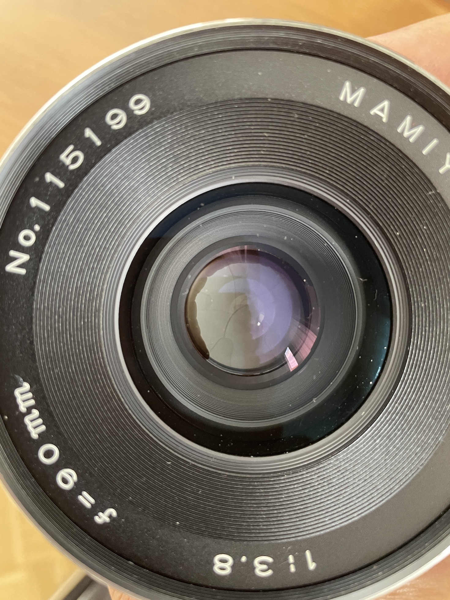

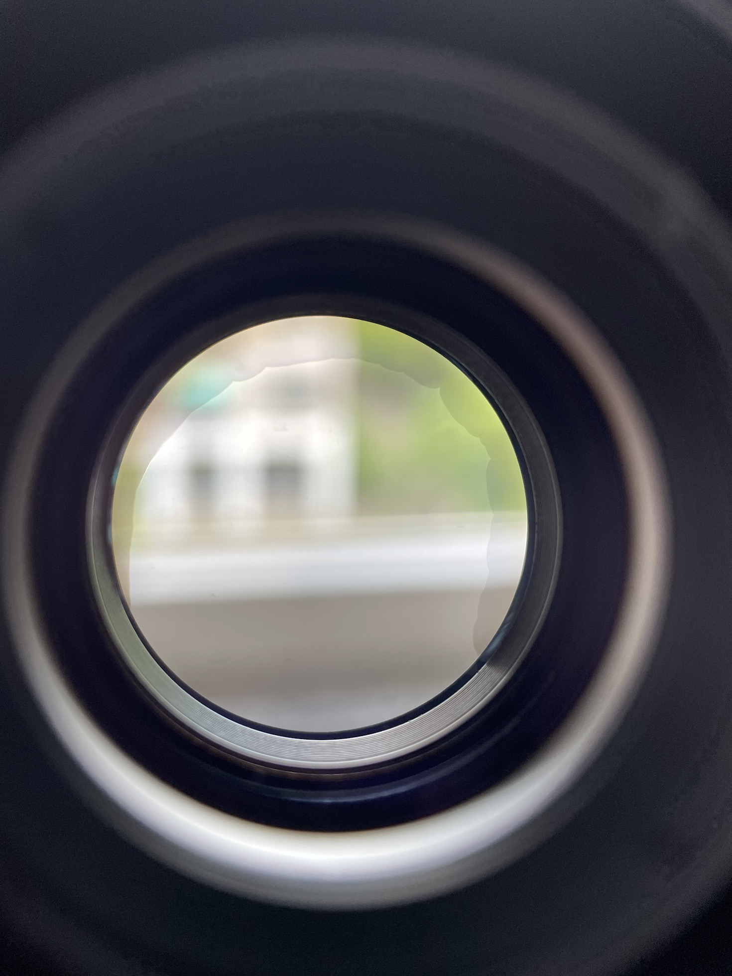

Hello everybody,
I just got a Mamiya Rb 67. It came with two lenses, the f=90mm 1:3,8 Sekor C and the f=65mm 1:4,5 Sekor C.
The reason I created this thread is that, on the 90mm lens, there seems to be a sort of veil covering a part of the lens. I have attached photos to illustrate what I am talking about. When I attach the lens, the veil is not apparent in the viewfinder...
Have you guys any ideas what this could be? I will definitely shoot a roll asap to see if this is going to affect the pictures.

Likely balsam separation. My 140mm f/4.5 macro has a similar defect. I can't say that I've noticed it in the images.
Valentins_Visuals
Jun 5, 2021
17
Berlin
Thanks guys, I’ll see if it affects the pictures or not... today I shot the first half roll and it was truly amazing. The shutter sound, the focusing, the advance lever... everything. I’m just in love with this beauty!
gone
Jun 14, 2009
5,504
gone
I think it's separation too. Just don't knock the camera around a lot and keep the lens from rapidly changing temps (like coming in from the snow into a heated room) and you should be fine. Should be, but I'd keep an eye on it.
