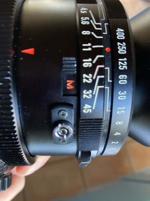

Hi, just bought the Sekor C 180mm 4.5, and need help understanding the buttons (I can't find a manual anywhere, and my Youtube searches have not answered the questions either)...

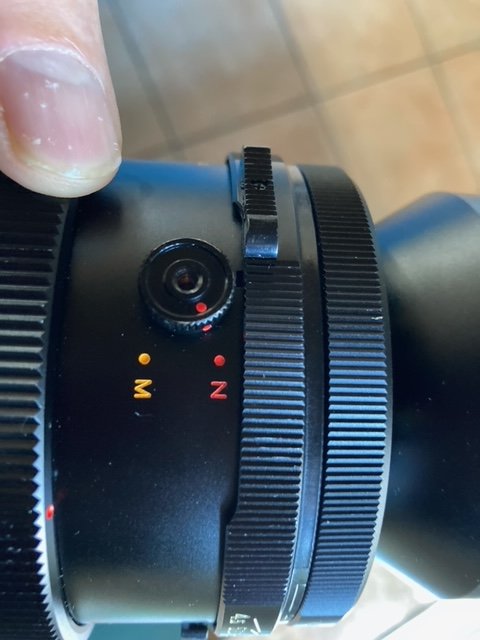

There are two buttons (see photos below) if you ignore the DOF preview button - I need to know what I use them for. The one alternates between M and X (first photo) and the second alternates between M and N where I presume the M stands for 'manual', and it appears to be a cable release socket.
Much appreciated!

M/X is the flash sync. Leave it on X unless you're using flash bulbs.
M/N is for Mirror lock up and Normal.
Much appreciated! My only other lens, the 90mm K/L makes the assumptions for you - if there is a cable in, it is in the alternative mode. So neither of the ports are accompanied by switches :smile:

Both the M/X switch and the mirror up operation are explained in the RB67 camera manual.
M/X switches are extremely common on lens shutters made up until some time (maybe the early 1970s or later).
