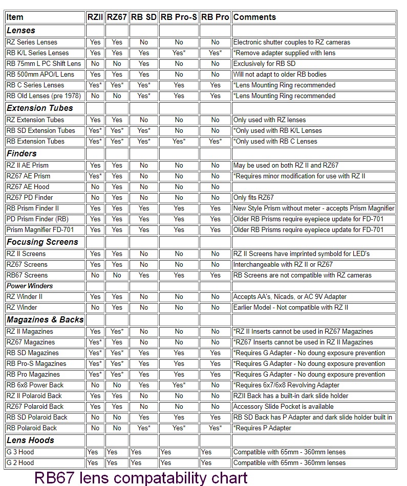

Is it possible to mount a Mamiya RZ67 Pro II Waist Level Finder on the original RZ67 Pro?
The instructions for RZ67 Pro II says it uses FW702, but it seems to be the same as the Waist Level Finder on the original RZ67.

This chart may help.

Thank you Sir
But it seems to not list the waist level finder, correct?
I was a little bit confused with the list as well. But I thought that maybe you could decipher it. Sorry if it doesn't help.

As far as I've been able to tell, there's only one version of the RZ WLF, and it fits all the RZ bodies. The incompatabilities only come into play for the metered finders.
