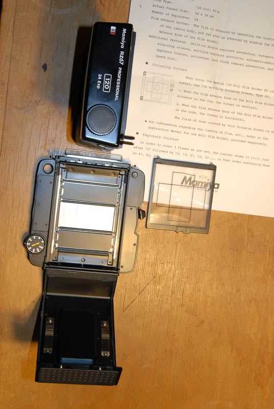

don't know what but something went WRONG :sad:
ok this is the 26x56 RZ back.
