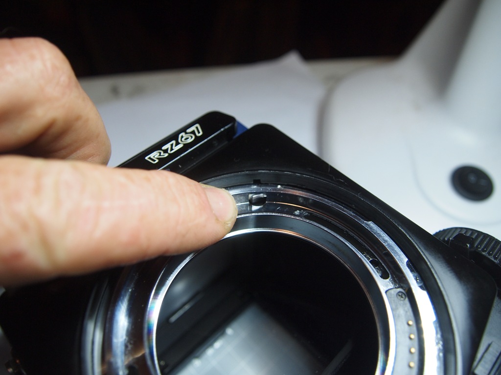

I can cock the lens off of the camera and fire it no problems. Once on the camera it wont fire, even after pre cocking the lens.
The only thing different between the lens is the cocking pins have a little more resistance on the 65mm lens. What I think is the problem is the camera hasn't quite enough strength to complete the firing of the lens.
Can I use a bit of silicon spray to put in the slot where the pins are? Or maybe there is some adjustment in the camera.....dont know any advise would be appreciated.

Actually When the small shutter lock pin on the lens is pressed down as it should be the cocking pins spin fine. Maybe the camera isnt depressing the shutter lock pin enough. Not sure if it can be tensioned?....anyway think Im getting closer to what the problem is.

No thats not it either. That small switch on the camera has nothing to do with the lock pin. There is a raised cylinder on the camera that holds the pin down.
