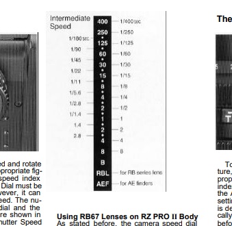

Oh perfect!
But what about the gear? I noticed that on the RZ67 PRO there is the option AE on the side gear, but there isn't on the normal RZ. How do you set your camera?

orange dot on the dial is the AE setting for the Pro-I camera body.
