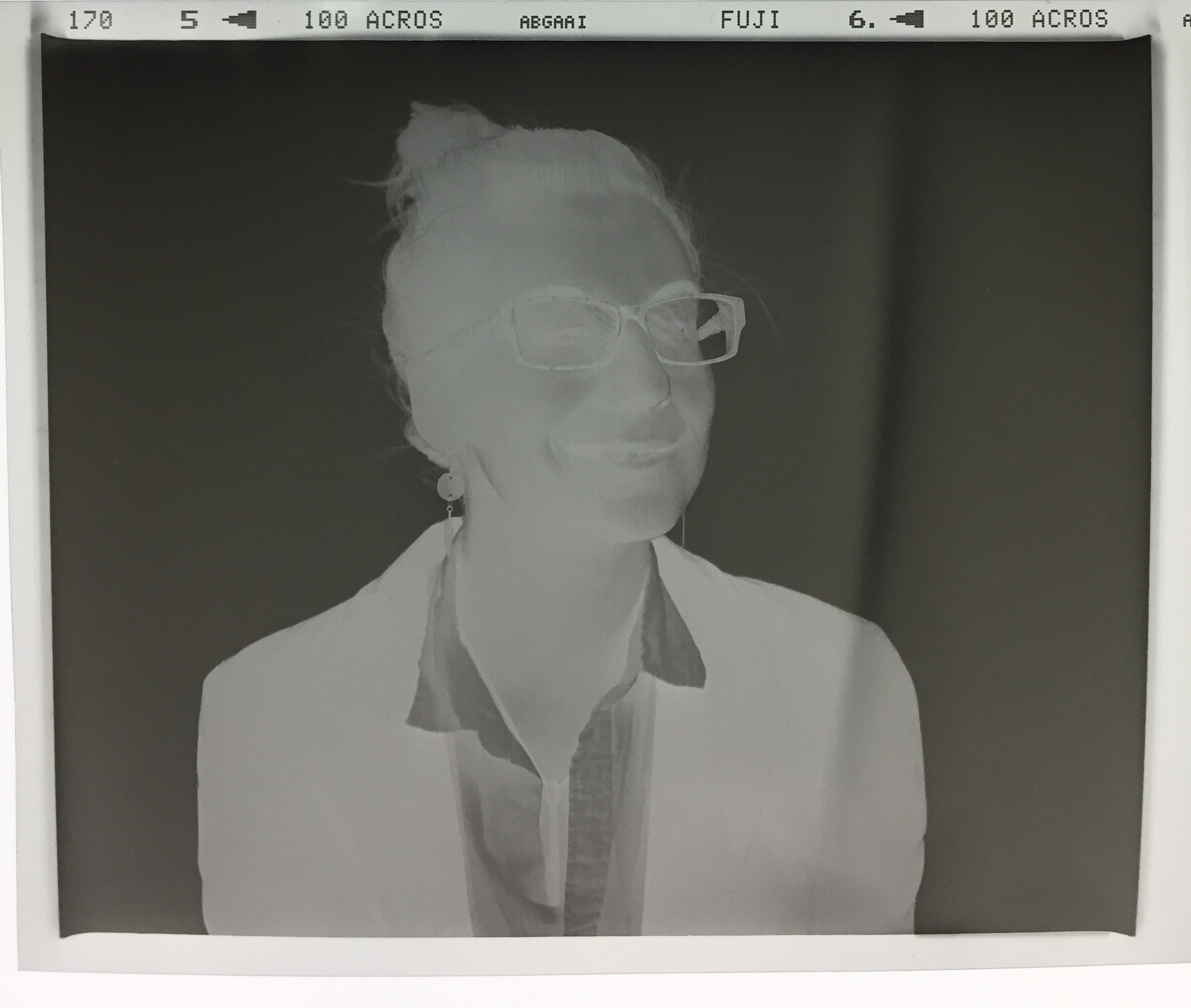

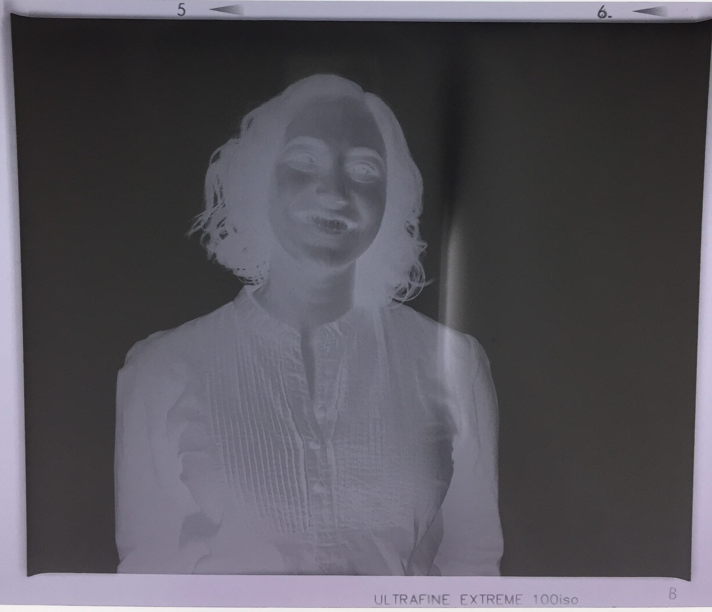

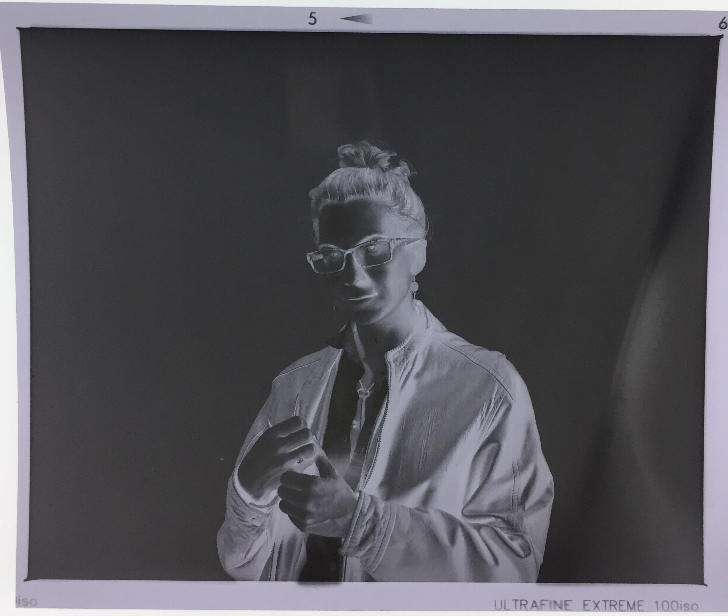

I have a consistently occurring problem with my Mamiya RB67 Pro SD:
On every third frame (of ten) there's a mark that looks like a kink in the film (see photos).
This happens no matter which of three film backs -- or which of three lenses -- I use. And, as I say, it appears only on the one frame per roll.
Any ideas on what might be causing this?

No luck. Same result. All I've established is that the tail end of the film isn't the cause. Nor, I imagine, is the leading edge, which bends out rather than in.
My next step, I think, will be to try a non-Ap reel, just in case there's something faulty about the two I have. (Not likely, but -- faintly -- possible.)

The film does not have to be touching to cause those marks. Measure the distance between the groves in the reel. If the end of the film is curving toward the next layer and reducing the space by 50% or more it will cause insufficient chemical flow between the rounds of film resulting in under development at those spaces.
Refixing the film may help clear them.

I've been developing roll and sheet film for several years, 120 film in various sizes (6x4.5, 6x6, 6x9, even 6x17). Which is merely to say I've made more than my fair share of mistakes. But it was only when I started using the RB67 in January of this year that the mysterious mark appeared. Hence my belief that the camera itself was at fault.
A belief I no longer hold, as it now seems most likely that in spooling the film I've somehow (and all too consistently) encouraged the leading edge to interfere with the development of the frame opposite it on the reel. (Looking at the roll as it hangs to dry, I can see quite clearly how winding brings these two together.) So it's not the camera or the film back or the reel or the tank ... it's me.
