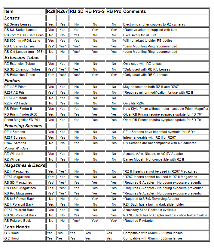

Best to pay attention to the Reznitsky compatibility chart then:
Found here: http://www.reznitsky.info/Mamiya/Comchart.htm
