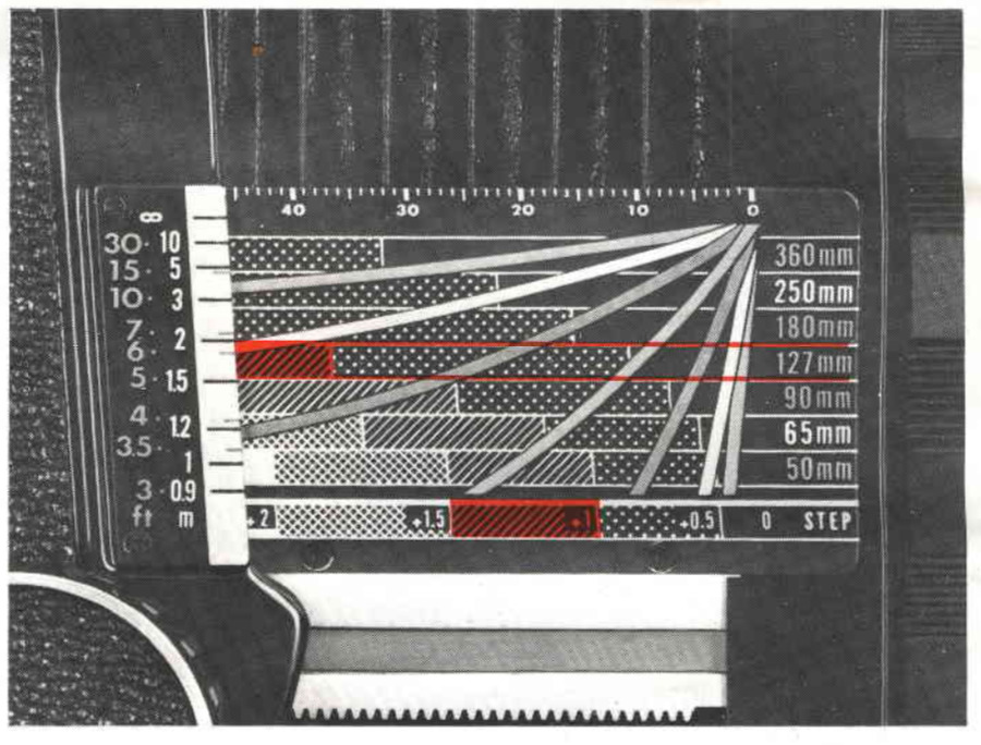

For clarity, I am attaching a screenshot of the image of the focusing scale in the original RB67 Pro manual.
You guys are reading the lowest bar of the Pro scale incorrectly. The lowest bar is like a legend, not a position scale. It tells you what pattern of hashmarks corresponds to 0.5, 1.0, 1.5 stops of compensation, but its positioning only corresponds to the bellows extension distance for the next-lowest row, which is a focus distance of 1 meter. This scale is also confusing because it makes the next-lowest row look like it's for the 50mm lens, but actually the 50mm lens is the rightmost curve, not a row (this is a little clearer from the matching colors in JWM's photo). In fact, the bellows factor of 0.5 at 5mm extension would only happen for the 50mm lens focused at 1 meter. The longer lenses need much more extension before requiring an 0.5 factor.
Mamiya appears to have figured out that the scale was confusing and improved the graphic design for the later model in JWM's photo above. They also eliminated the +1.5 and +2 hash markings, perhaps because hardly any lenses were being used in the regimes where the +1.5 and +2 factors would apply.
In the Pro SD scale, the borders of the 0.5 and 1.0 regions aren't a smooth function of focal length, I don't know why that is but I suspect it has something to do with the lens optical designs (something about the principal planes not being the same as the focal length distance, for retrofocus lenses).

The manuals for the pro sd and the pro are on butkus and they show that mamiya clearly updated the compensation indicator plate at some point.
You can also see that the maximum bellows extension has not changed between the two versions.
Also the magnification tables show the same values and the focusing charts match for all of the focal lengths.
So something doesn’t add up.
It could be that the compensation chart for one of the models is off by up to 1 full stop or it could be that they’re both off.

The chart in Post 6 does not quite makes sense...50mm FL with 50mm extension achieves 1:1, which entails a 2EV increase in exposure.
Yet the graphics show +2EV being needed at 43mm extension.
At 1/2 mag, the exposure increases by 1.5EV, and the scale correctly shows that.

Thanks to all of you here. Discussion is helpful. Guess more of what I was seeking was confirmation that my eyes weren't deceiving me and that indeed, the presentation on the chart had changed. Cause remains undetermined but what we have here are 3 possible explanations - two from Matt:
The different lenses attain infinity at different amounts of bellows extension, but the actual physical extension doesn't necessarily match the focal length for the retro-focus wide angle lenses and the telephoto longer lenses.
Thus the need for individualized curves.
And yes, use the bottom bar as a legend.

I would circle back to the possibility that the differences in the appearance of these scales between the PRO SD (post # 2) that I have and earlier (post # 6)... and hope that it is not due to the change from C to KL lenses. And I would hope this BECAUSE it would suggest that if you're putting a C lens (like my 50mm C) on a PRO SD made for KL lenses, then you are SOL, and I can't imagine Mamiya would want to mess with me like that... so that I'd have to use ONLY KL lenses on the PRO SD.
I don't have time to study this out this morning because of an upcoming meeting, but maybe the graphed adjustments between the 2 scales don't actually change while the presentation does? If so, then that would confirm that Mamiya was really motivated to eliminate user confusion. Note that I don't at this time own a lens extension.
MattKing
Apr 24, 2005
53,144
Delta, BC Canada
I doubt you have anything to worry about with the C lenses.
But I would point out that the scale is an aid - designed to help make some things simpler and easier. If you have a lens whose flange distance differs from the more current version, you might not have access to that aid - you might need to do more manual calculations, based on magnification. That of course is what just about every LF photographer does.
You can always check by seeing if the distance scale matches up to reality. If it does, the close focus exposure adjustment will as well.
