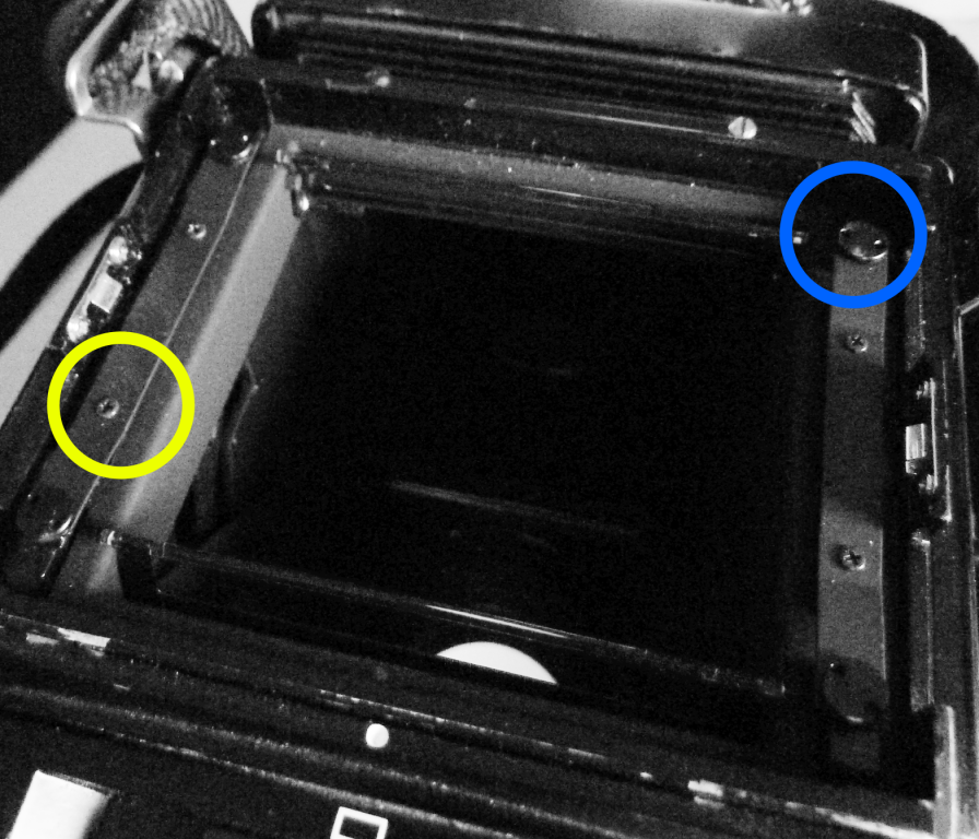

@cramej: I was unaware of that possibility. Can you indicate precisely which screws you mean? If it helps, I have identified three candidates, circled in the various colors in the images here:
https://ibb.co/sqvpsy3
https://ibb.co/m6PnSdV
The one circled in blue is correct.
See here for more details: https://www.photrio.com/forum/posts/?post_id=1403382
By looking at your sample photos, you would need to lower the screen.

b2545
Oct 26, 2010
9
I had to do this to my RB. At that time, I did not have a loupe and now that I do, I think I need to check this adjustment on mine again.

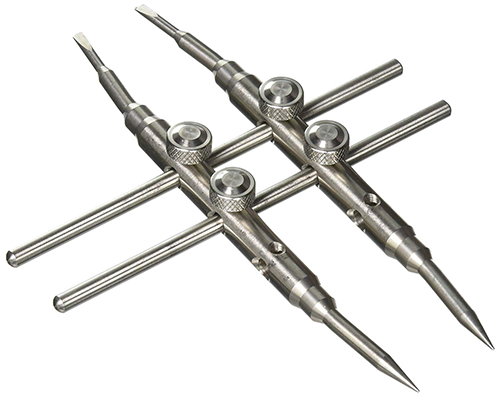

Thanks @cramej!
I feared it would be the blue one. I don't have a two-pronged screwdriver.

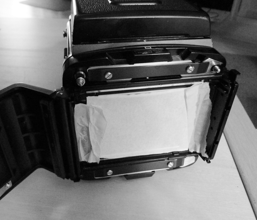

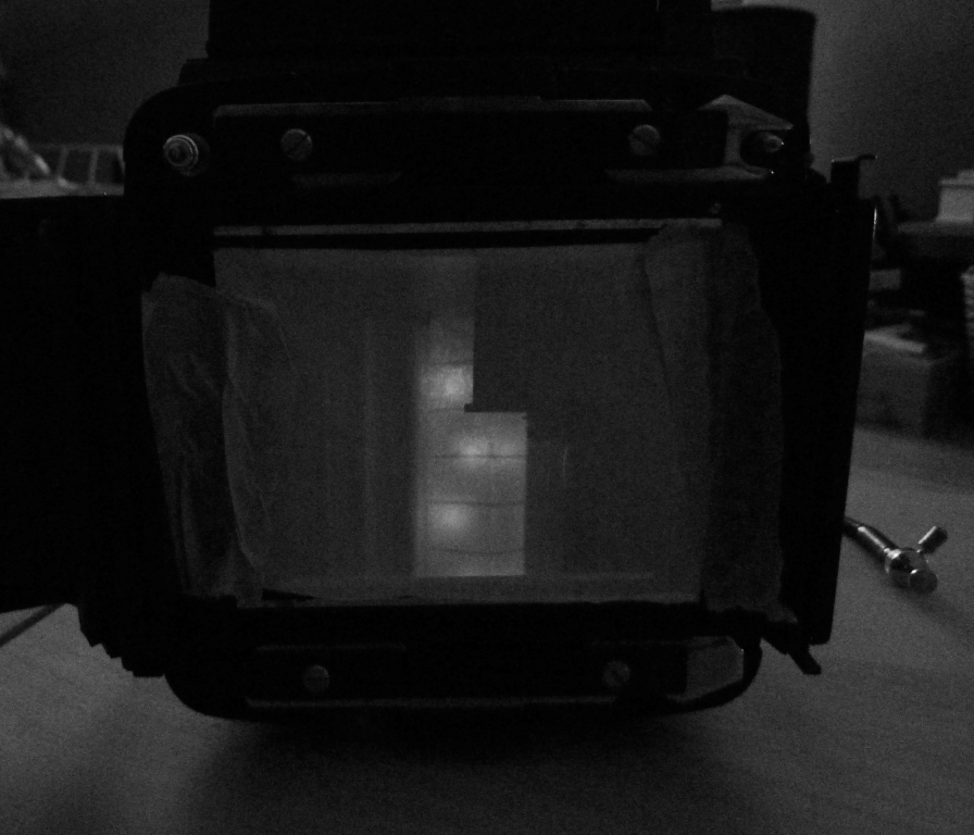

Crudely, the verification procedure being suggested is this (substituting ground glass for the paper in the photos, and using a loupe for accuracy):
If it is indeed the focusing screen seating which needs adjustment, the screws in question are the ones circled in blue here:
There are four of them, one at each corner.
To make ground glass, I have found the following to work well enough: Starting with piece of clear glass (about 6.5 cm by 7.5 cm in this case)... grind it evenly rough on one side with abrasive powder (protect the other with tape).. The best is to grind one piece of glass against another (larger) with abrasive powder (and a few drops of water) in between. Wash thoroughly with plenty of water, and then remove the protective tape. When finished, the glass should go in place of the film in the camera back, rough side towards the lens.
cramej
Dec 29, 2009
1,235
Two mechanical pencils with metal tips can work in a pinch. Insert them at an angle in opposing directions and push - very carefully. It's like trying to pick up a grain of rice with a chopstick in each hand.
b2545
Oct 26, 2010
9
Ok, so perhaps two pieces of stiff wire of the appropriate guage, taped firmly to a piece of wood of rectanglar section and thickness matching the hole-to-hole distance would provide more assurance?

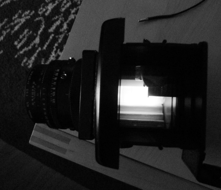

I don't have a cable release, how can I open the shutter with the mirror up? Tried it with the knob on the left side of the lens, but it doesn't work...

I could be wrong on which way the screen needs to go...
Just need the shutter on T. Check focus on the screen for a particular point of focus, trip shutter, check back.
