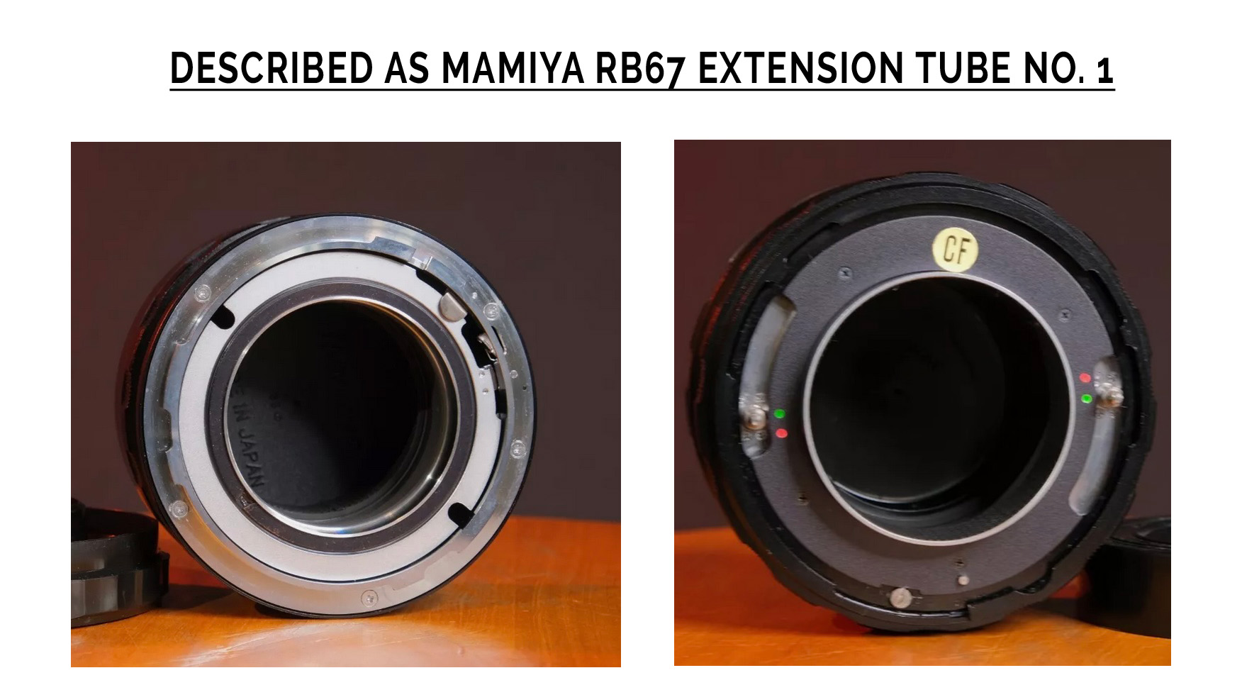

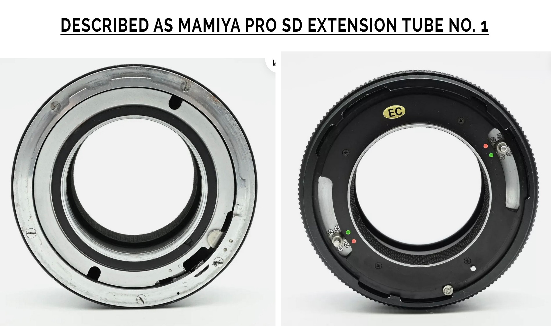

I just purchased a Mamiya RB67 Pro S with a 65mm C lens. I would like to use an extension tube with it and, from reading the user manual, only the No. 1 tube may be used with that lens. Additionally, from reading other forums, it seems that the Pro SD tubes will not fit the Pro S camera mount. My question is in looking for a No.1 extension tube that will fit my camera, is there an easy way to tell the difference between an S and an SD tube just from looking at images on ebay?
Seems as though ebay sellers might not necessarily understand, or appreciate the distinction in their descriptions. The 2 sets of images appear to be the same, but are described differently. Any suggestions would be appreciated.

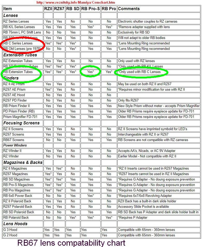

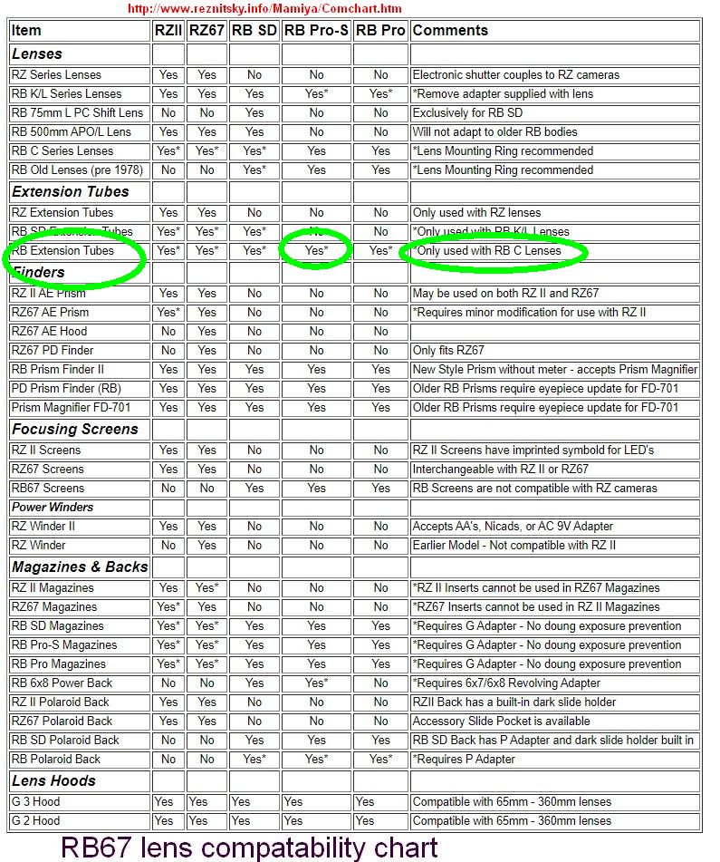

Here's the compatibility chart.

Looks like you want the RB67 No1 ext tube.

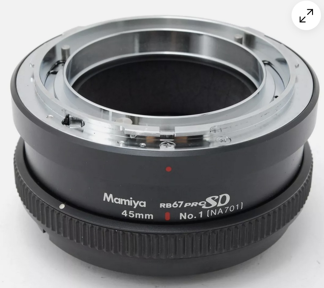

Thank you for the chart — I think I found the answer to my question — it seems that the sd tubes have the sd moniker on the side of the tube.

While the mount itself doesn't change between the Pro, the Pro-S and the Pro-SD, the Pro-SD has a larger "throat" area than the Pro-S and the Pro. That was necessary to accommodate a couple of the larger K/KL lenses: the RB 75mm L PC Shift Lens and the RB 500mm APO/L Lens, which are too big to fit on the earlier cameras.
The SD extension tubes are probably larger in diameter, and fill that larger throat.
The earlier tubes most likely work on the SD as well, but the accessory lens mounting ring that helps increase the stability of the mount is recommended.

The chart mentions that there are pre-1978 lenses. Could those be different than the later RB pre-C lenses?

I believe that 1978 was when the C lenses came in, but @Mamiya_Repair would likely know more.
