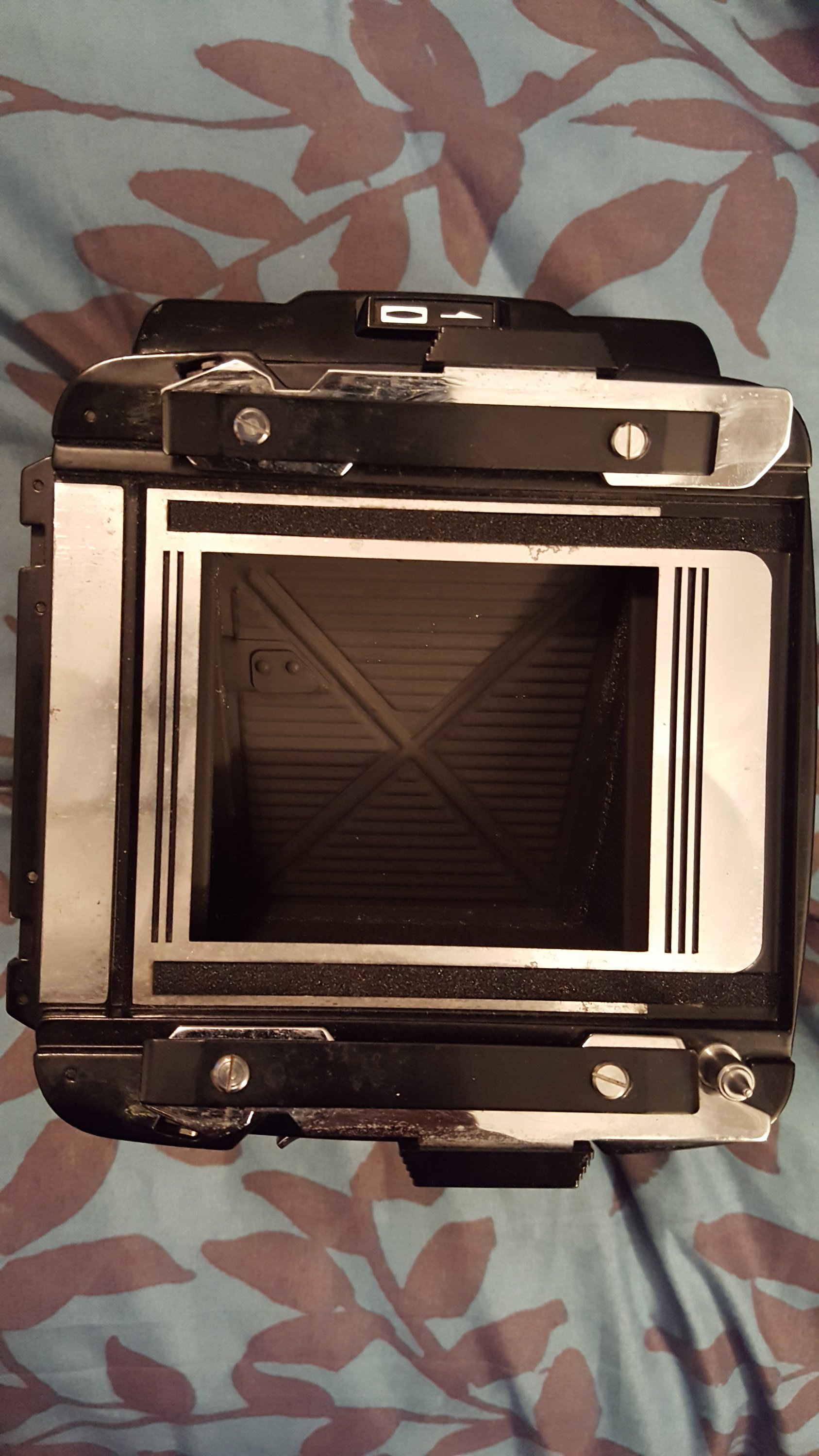

Hi all,
I bought a RB67 from KEH & received it today. Purchased the body, back & lens separately. I'm having an issue with the rotating part of the back & can only connect the 120 film back upside down. I know this sounds odd & I've tried to rotate this back every way possible. It turns 1/2 turn from portrait to landscape as expected, however when in landscape mode, the film back is completely upside down.
I have taken off the rotating module completely, but it only mounts onto the body in one way, which makes the back mount upside down (back also mounts only one way due to a notch in the back). What am I doing wrong here? Thanks in advance!

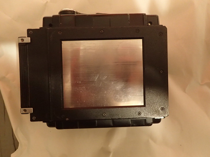

Can you upload a picture so we can see this?

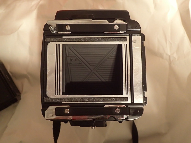

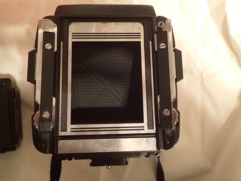

I pulled mine out and took a look. Not seeing how that would work. Starting in landscape orientation the back will rotate 1/4 turn clockwise to portrait and the reverse back to landscape. As you state the rotating mechanism will only mount one way and the film back will only mount one way to the back of the camera. Mine has an outline which is on top for whichever orientation you are set to.
Landscape
P4290690 by lmmiers, on Flickr
portrait
P4290692 by lmmiers, on Flickr
120 6x7 back
P4290691 by lmmiers, on Flickr

Yes, I'll upload a photo in just a sec. But I can tell you from looking at your photos, mine is the exact opposite. In landscape mode, the little pin sticking out, is on the lower right side.

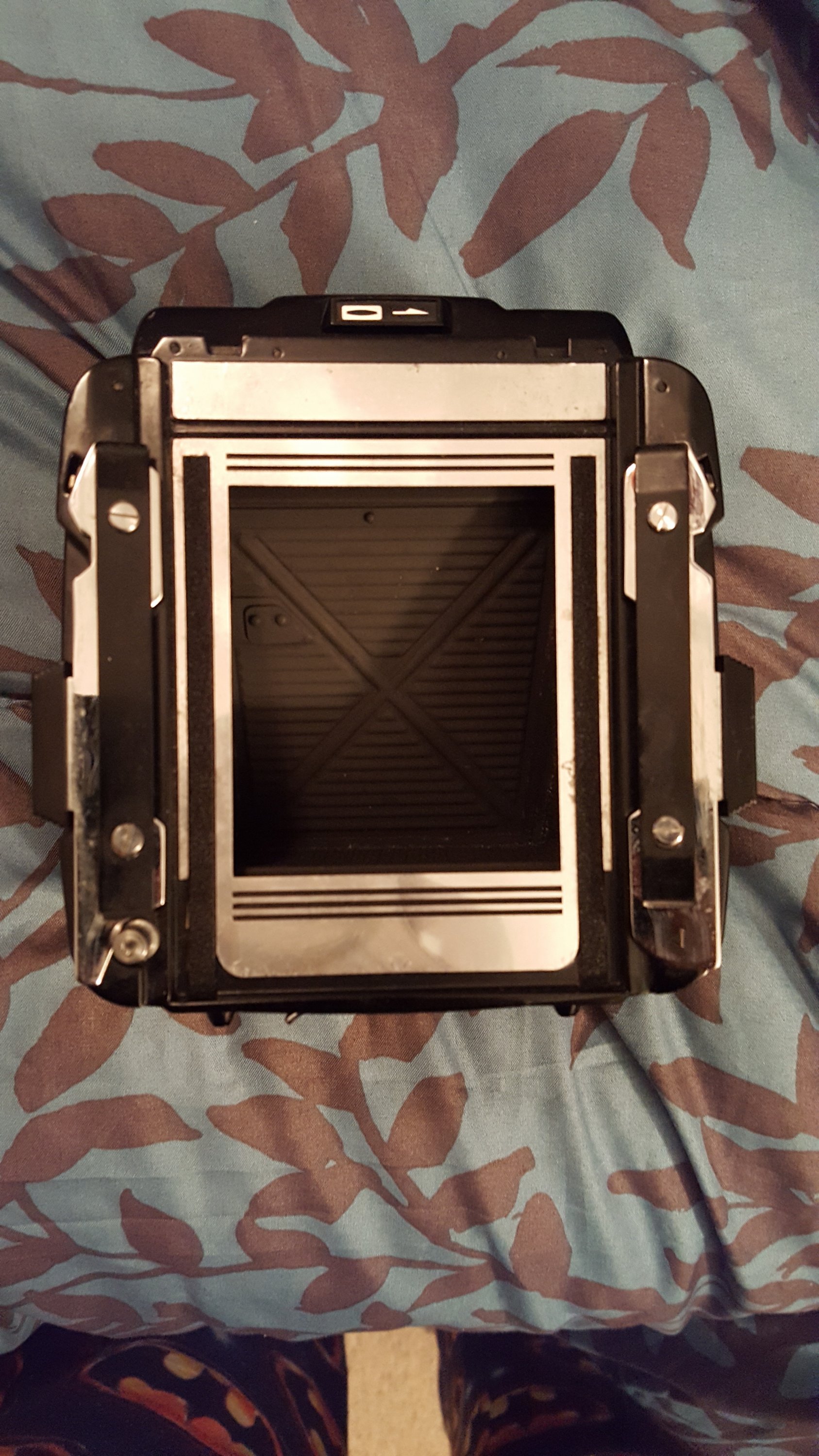

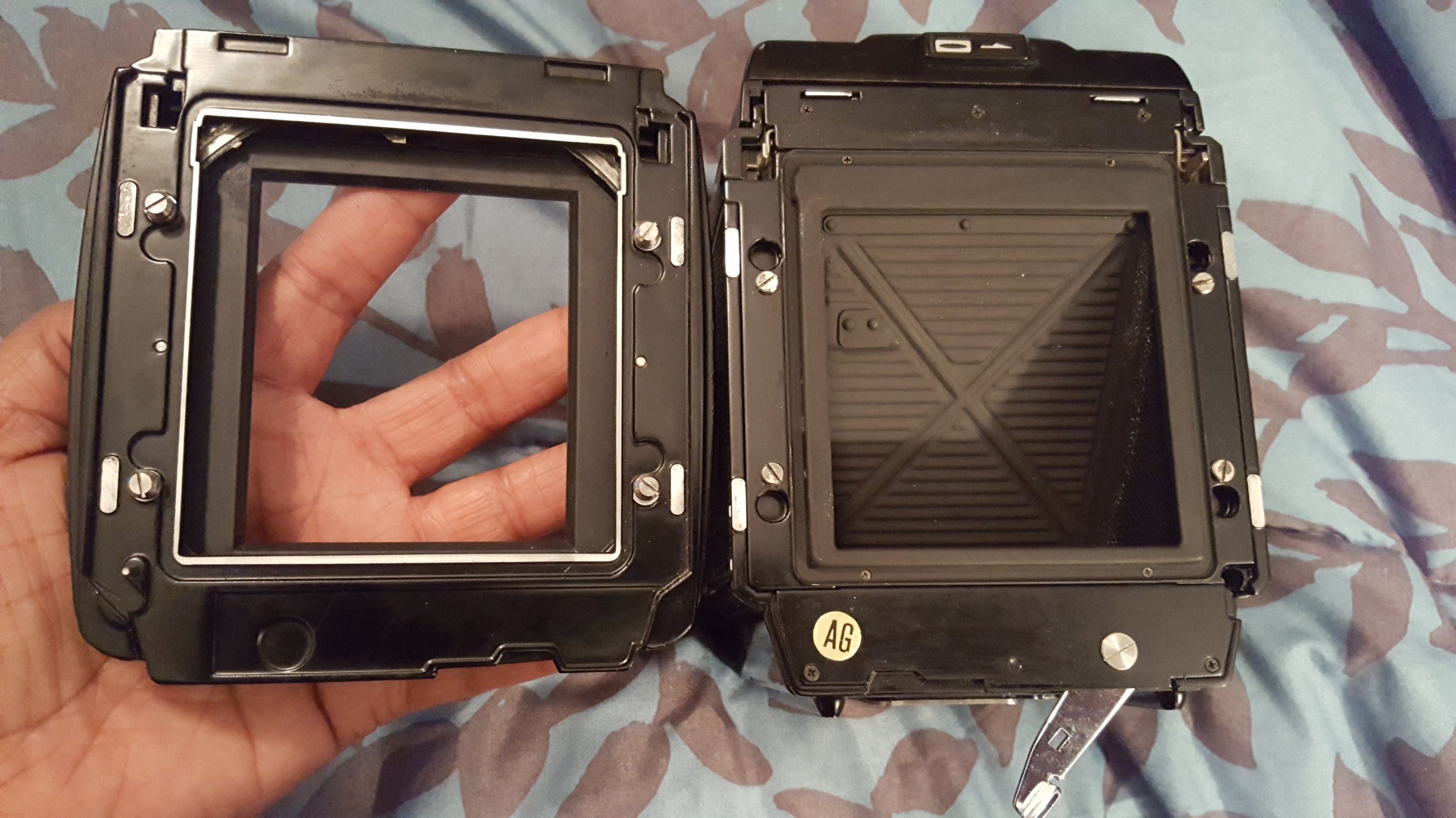

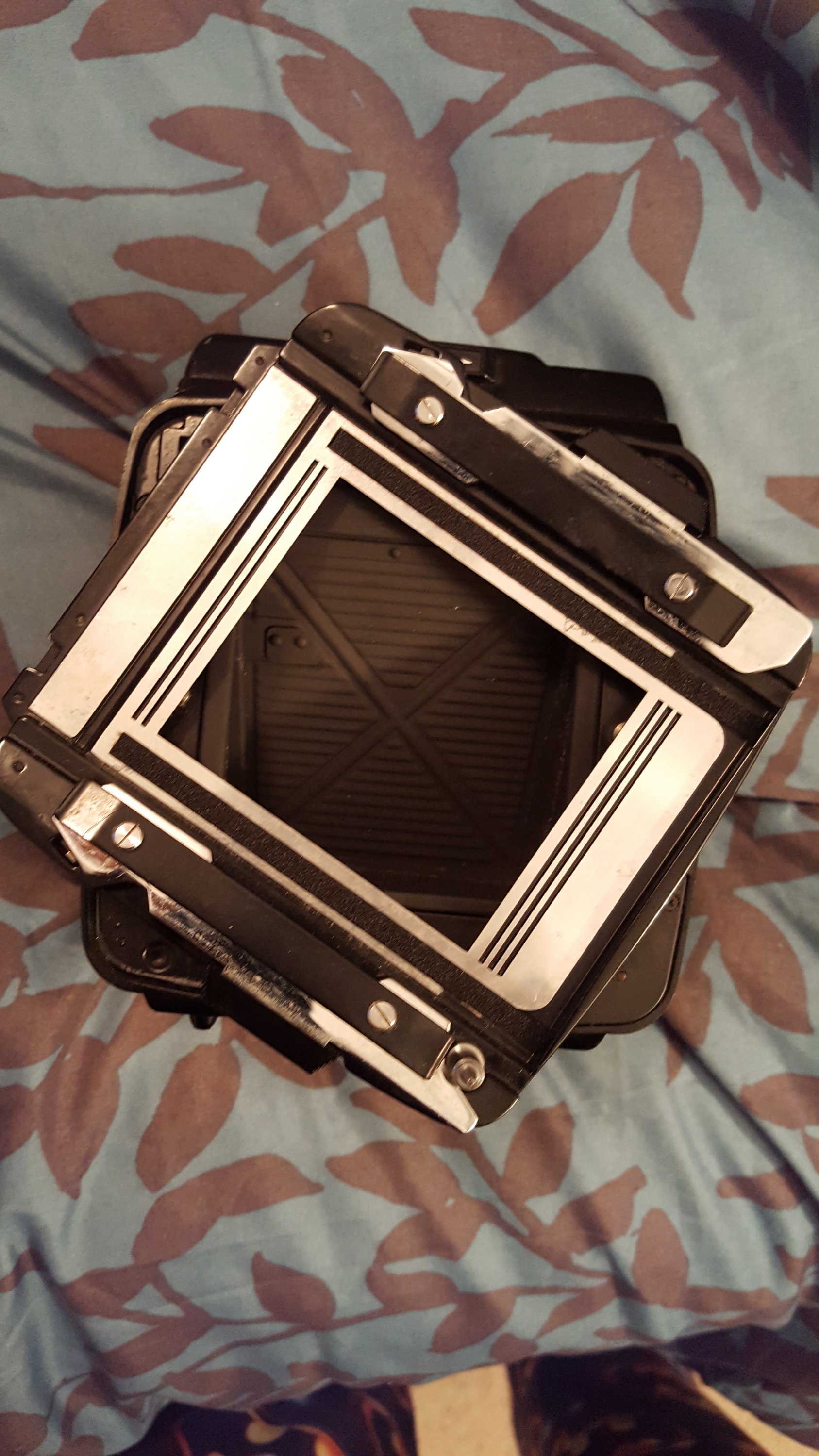

Photos of the camera back. Took a couple of photos in portrait & landscape mode of the back, along with the direction it turns. As you can see when I take the entire setup off the back, it only installs one way due to the notches in the body for the back to fit into. I'm completely clueless as to the issue here.

I don't think your mounting the film back onto the rotating portion of the camera correctly. In landscape orientation, the dark slide should be to your right, looking at the back of the camera. In portrait orientation, it should be on the bottom.

@480sparky - I can't put the rotating portion on the camera body any other way. I will post another pic with the film back on. Forgot that one initially. And I'm 100% sure something is wrong (most likely user error) because I have to push the little tabs in to get the film back off when I put it on instead of being able to simply slide the levers to the left to release the back.

Something is wrong with the rotating part. Mine is exactly 180° apart from yours.

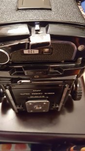

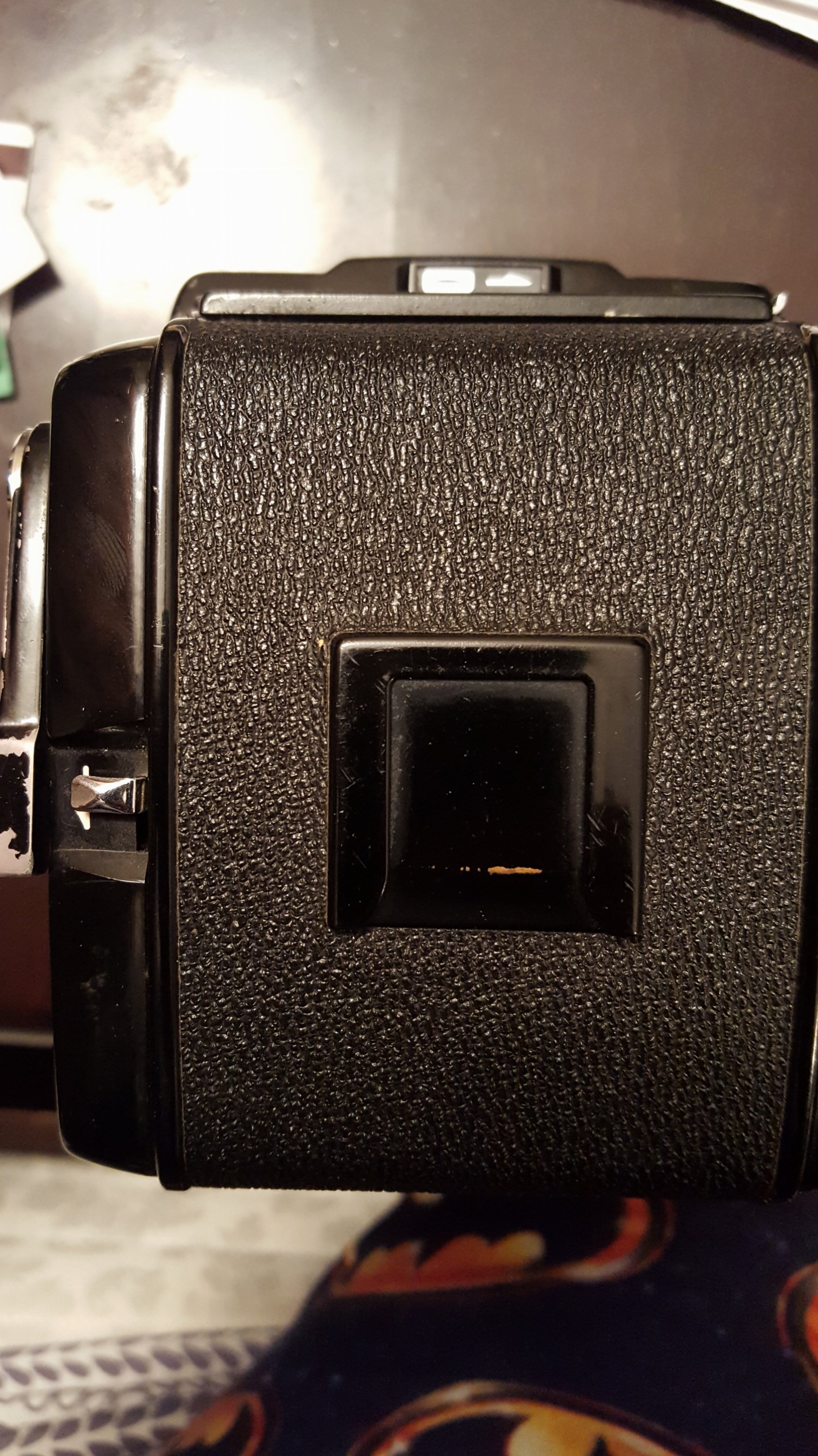

Ok here's the back with the 120 film holder installed on back. I swear this isn't my first MF camera so I'm really feeling like an idiot tonight! Thanks all for helping me with this issue.

Comparing mine to the OP's it looks like the mount for the rotating back is correctly oriented. My suspicion is that someone has disassembled the mechanism and put it back together reversed but I do not know if that is possible,
Ok this makes me feel like I'm not crazy. I saw the same in Larry's post above also. So this camera back has some sort of issue. I'll contact KEH on Monday for a new back or a refund because this one only installs one way. Disappointing, but I'll patiently wait for another one. :smile:

Sumpin' is effed up with the RB portion. Yours is rotated 180° somehow. I wonder if someone disassembled it and put it back together wrong.
