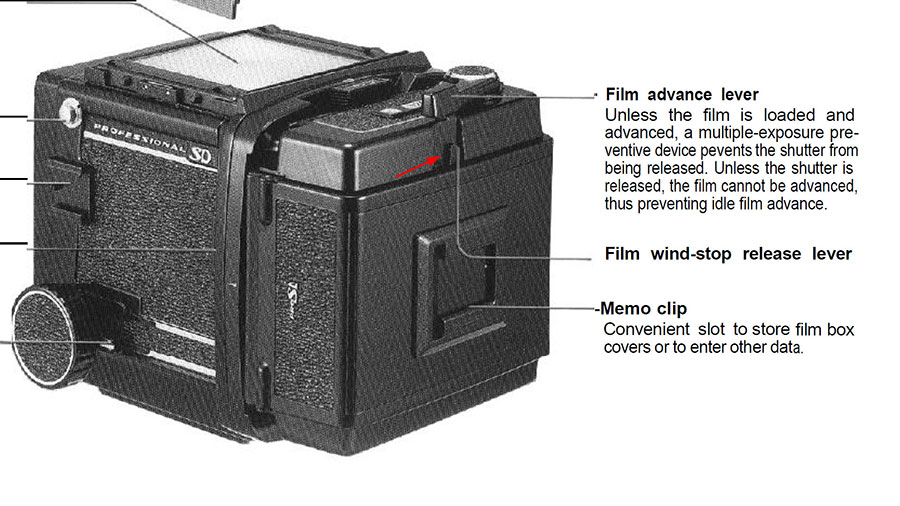

Dunno if there is something wrong with the back, hope to goodness not. This is my first roll with it, and though the film was advanced to 1 and the shutter was cocked, it would not fire.
Eventually I used the multiple exposure option to fire it, but then I couldn't advance the film.
So then I had to use the film wind-stop release lever (see red arrow on image to confirm which lever I am talking about) to allow the film to advance, after which I was able to fire the shutter in the usual way. Ditto for the next exposure, at which stage I stopped.

The purpose of the "film-wind stop release" lever, far as I know, is to allow you to roll-off an unfinished roll of film without having to fire the shutter for each frame. If you use 120 film in a 220 back, it's a faster way to wind-off the backing paper since the back thinks you still have ten frames to go. The usual position of the lever is to the right (as shown in your pic), and it's spring loaded - you have to hold it to the left for it to disengage the winding from the shutter/cocking mechanisms. It basically unlocks the film-winding lever so it's independent of the camera body.
Beyond that, I don't know - the RB operates with linkages and pins that come from the camera body and through the revolving adapter, and if those get bent or stuck you can have problems, usually problems with the camera's safeties not letting you fire the shutter. You might send a message to MamiyaRepair.com, that guy is 100% legit.

Check if the red indicator mark appears in the exposure counter window of the film back when the shutter is released.
If that red mark does not appear the linkage between the camera body and the film back is faulty.
In effect the film back "thinks" that the shutter has not been released and the double exposure prevention interlock will prevent the film from being wound on.
This interlock can be defeated by moving the multiple exposure lever forward and uncovering a red warning dot.
The interlock can also be defeated by pushing the film wind-stop release lever to the left.
The underlying problem is that the moving pin system that connects back and body and signals exposure is jammed
or maybe the revolving adapter and/or the film back are slightly out of alignment.

Yes, I know the lever is for winding off the remaining film when it is not finished - hence my needing to use it can be seen as a symptom indicating a problem elsewhere.
The lens is firing on 'normal' - on this particular K/L lens the only way of getting the lens into 'manual' mode is to screw the cable release into the socket tightly enough, i.e. there is no switch.
I think in the end Maris' input is getting closer to the issue... I tried a shot, which wouldn't fire until I went into multiple exposure mode, and then it wouldn't wind once more.
This time, instead of using the wind-stop lever to advance the film, I removed the back and firmly re-attached it, and was able to advance the film in the normal way. Now to find something else to do a test shot on! :smile:

Just an update, in case this helps anyone else: it seems the main culprit was the little fellow in the middle on the left third in the accompanying photo of the camera-side of my film back... it's a little metal panel that slides out when you advance your film, covering a hole underneath. This prevents a little rod inside one of the registration pins from going as far as it wishes to, hence letting the camera know the film is advanced and that you can shoot.
Once I worked this out, it was a simple step to realise all I needed to do was jiggle/tap the film advance lever to bring it out, and when that happened the little red flag would appear by my exposure number.
