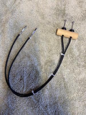

I made this double cable release up many years ago now specifically for mirror lockup usage and have used it on every lens I have from 37mm-180mm to date without one issue. I can't think of any image I've shot 30+ years with the RB without using mirror lockup.
