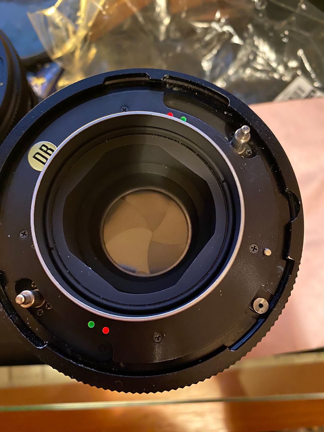

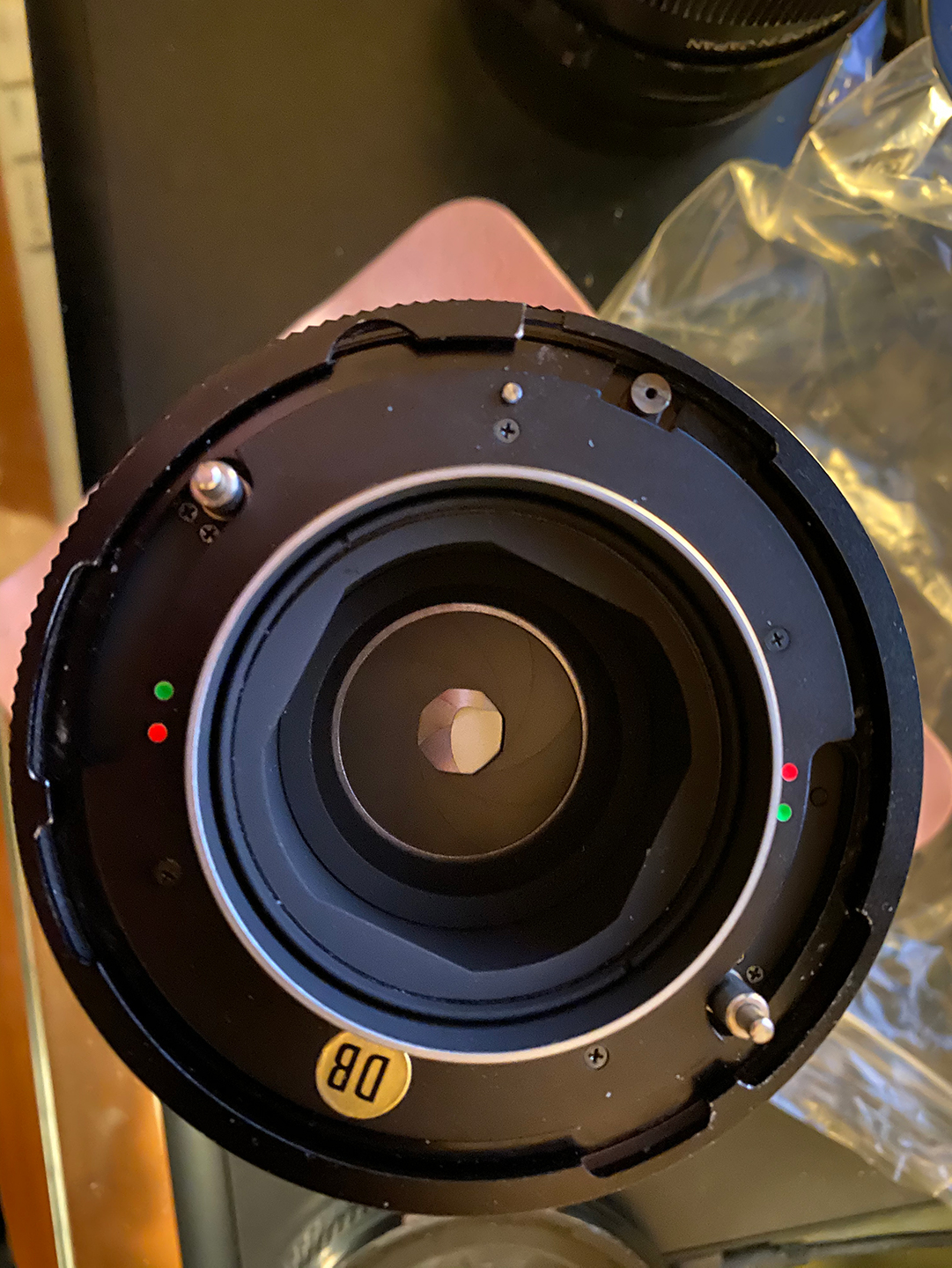

Mirror lockup was on 'N.". The lens sounded better or more "normal" off camera. I then notice something interesting/weird testing and looking into the shutters. There seem 2 layers of shutters, but as I keep firing the shutter, it seem to went back to normal. I attached a couple of pics.
Nevermind on the pics. I realized it's the aperture. Newbie still learning.

Yep, when you cock the lens the shutter and aperture open up so you can see through the lens to compose and focus. When the pins are rotated to fire the shutter, the shutter first closes so the mirror in the body can be flipped up and the aperture closes down based on the aperture setting. As the pins reach the end of their travel, the shutter opens and closes for the duration of the set shutter speed.
